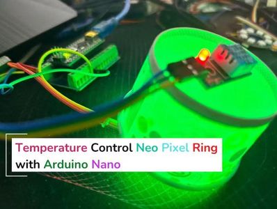

Step 2: Connecting the Hardware
First, connect the DHT11 sensor and the Neo Pixel ring to the Arduino Nano. The DHT11 sensor can be connected to any digital pin on the Arduino Nano. The Neo Pixel ring should be connected to the D2 pin of the Arduino Nano.

Step 4: Programming the Arduino
The next step is to program the Arduino Nano. The program should read the temperature from the DHT11 sensor and change the color of the Neo Pixel ring based on the temperature.
For example, you could program the Neo Pixel ring to display a blue color when the temperature is below a certain threshold.
A green color when the temperature is within a comfortable range,
and a red color when the temperature is above a certain threshold.
Step 5: Testing the System
After programming the Arduino Nano, it’s time to test the system. Power up the Arduino and observe the color of the Neo Pixel ring. Try changing the temperature around the DHT11 sensor (for example, by blowing hot or cold air onto the sensor) and see if the color of the Neo Pixel ring changes accordingly.
