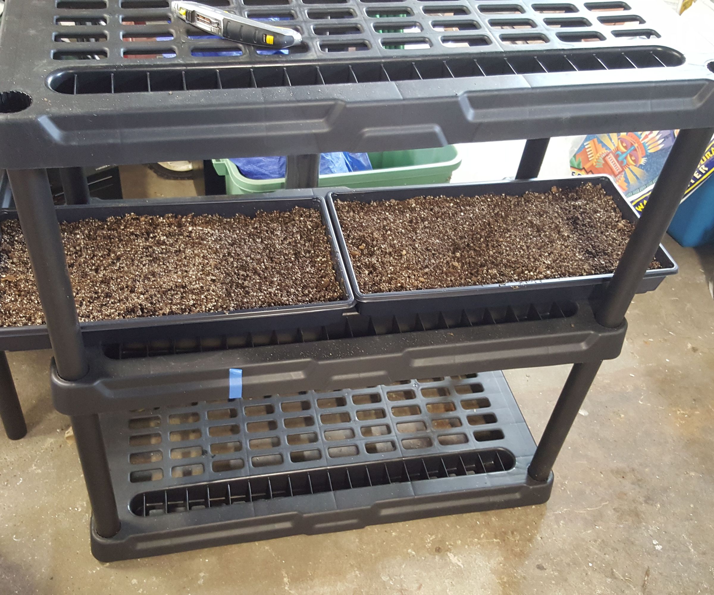

Step 2: Attachment
I used double sided tape to fasten the foil so that it fit snug in my seed starting tent. Then you drop the temp probe down wherever you are regulating temperature and set to your desired temperature. When it gets to hot the fan turns on and pulls hot air from the top out to cool off the items inside.
