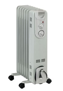

Use your wire stripper to cut the electrical chord off your space heater. If you have an extension chord that you want to use for this part instead, it will work equally well and you wont have to cut the chord of your space heater if you're worried about damaging your heater.
Strip the casing back on the power chord and inside you will find two insulated wires. Strip the casing back on these as well and solder the contacts of the relay in between two sides of one of these wires. It does not matter which wire you solder it in the middle of, however, it is important that you do not accidentally cross your wires. (i.e. each wire should be re-soldered back together after being cut apart but one of them will have the contacts of the relay in the middle of it breaking the connection.

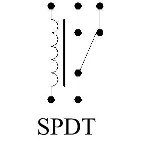

Remember that in the orientation shown, the bottom two contacts on the relay are the coil contacts. The one on the right is the single pole, and the two on the left are the double poles. We want to connect our power to the contact that is normally open. This means that our space heater will normally be in the off state except when the coil of the relay is energized. The contacts for the coil of the relay will be attached to outputs of the Arduino. We will cover this setup more in two steps.
After you finish soldering everything together, wrap everything in several layers of electrical tape. You should never have live power like this open to the air on the chance that something gets shorted out. This could be a fire hazard and also a shock hazard. Be Careful!

A relay is an switch that is controlled by adjusting a voltage. The one that we are using is a 5 terminal device. 2 of the terminals control the coil of the relay. When the voltage across the coil is below the pickup voltage, one connection will be made. When the voltage across the coil is above the pickup voltage, the other connection will be made. This is a SPDT relay, or Single Pole Double Throw.
We need to use this relay because space heaters typically use a lot of power. The space heater that I use requires 1500W. This means that we will need to control 1500/120 = 12.5 amperes. If we tried to control that much power with our MOSFET, it would be destroyed. Instead, we will use the MOSFET to control the voltage across the coil, and let the relay contacts control the larger amount of power.

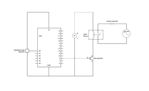

Assemble your circuit according to the attached schematic. Make sure that you physically put your temperature sensor somewhere far enough away from the space heater that the readings it measures are representative of the whole room.
Step 4: Understanding the Circuit
The main challenge in designing this circuit is that we need to control a large amount of power using our Arduino and we don't want to destroy the board. Understand that each pin can only output 40mA of current at 5V. The coil of our relay has a pickup voltage of 3.3V, however, according to the datasheet it will draw 185mA which will easily destroy the Arduino board. For this reason, I decided to use the Arduino to control the gate of a power MOSFET. This will be small enough for the Arduino to be safe and the power MOSFET is capable of controlling enough power to drive the coil of the relay.
