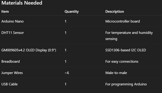

Materials Required
Arduino Nano
DHT11 Sensor
GM009605v4.2 OLED Display (0.9")
SSD1306-based I2C OLED
Breadboard
For easy connections Jumper Wires
Male-to-male
USB Cable

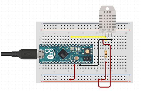

Step 1: CIRCUIT DIAGRAM
CIRCUIT DIAGRAM

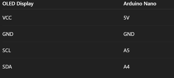

OLED Display Arduino Nano
VCC ---------- 5V
GND --------- GND
SCL ---------- A5
SDA --------- A4

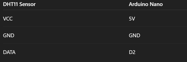

DHT11 SensorArduino Nano
VCC --------- 5V
GND -------- GND
DATA -------- D2

Step 4: Troubleshooting
Troubleshooting
  1. No display output: Check I2C address (0x3C is default for SSD1306).
  2. Nan values: Ensure DHT11 is wired correctly and has a pull-up resistor (if using a bare sensor).
  3. Flickering display: Increase delay in loop() to 2-3 seconds.
