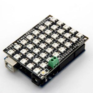

  • NeoPixel Shield for Arduino - 40 RGB LED Pixel Matrix
  • Arduino UNO

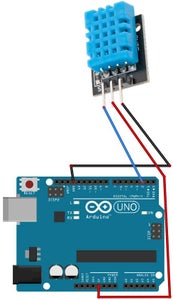

  • Connect DHT11 sensor pin[S] to Arduino digital pin[2]
  • Connect DHT11 sensor pin[-] to Arduino ground pin[GND]
  • Connect DHT11 sensor pin[+] to Arduino positive pin[5V]
  • Attach the Shield to Arduino Uno, You can find More Info here

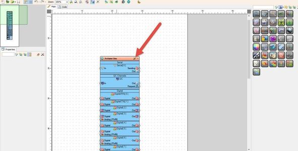

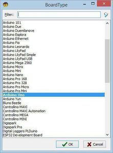

Start Visuino as shown in the first picture Click on the "Tools" button on the Arduino component (Picture 1) in Visuino When the dialog appears, select "Arduino UNO" as shown on Picture 2

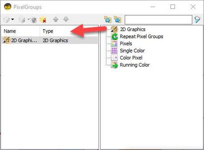

  • Double click on "NeoPixels1" and in the "PixelGroups" window drag "2D Graphics" to the Left side and in the properties window set "Height" to 5 and "Width" to 8, Select "Elements" and click on the 3 dots button

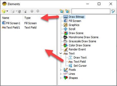

In the "Elements" window:
  • Drag "Fill Screen" to the Left side

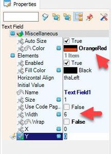

  • Drag "Text Field" to the Left side & in the properties window set "Color" to OrangeRed and "Width" to 6, "Wrap" to False, Select "Elements" and click on the 3 dots button
  • Drag "Font" to the Left side & in the properties window set "Font" to Adafruit\Picopixel

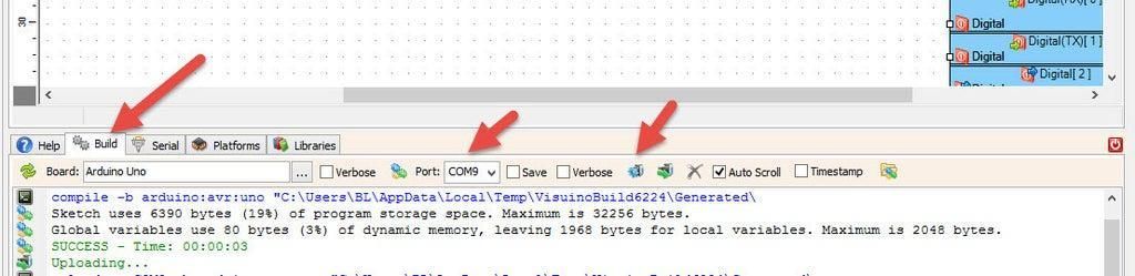

In Visuino, at the bottom click on the "Build" Tab, make sure the correct port is selected, then click on the "Compile/Build and Upload" button.
