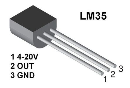

Step 5: LM 35 Connection
Ground pin 3 of lm358 and connect pin2 of temperature sensor IC(LM35) to pin 3 of the OPAMP. Connect pin 1 of Temperature sensor IC to VCC and Pin3 of it to ground.
