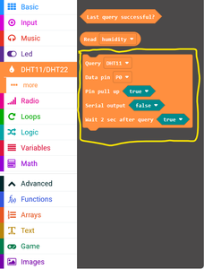

open a new project in makecode
drop down advanced and click extensions and add dht11 in your extensions
Step 3: Change Pin Pull Up

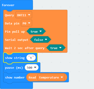

get a query and put it in a forever

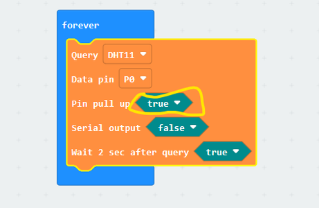

change pin pull up to false if you want it to fail less
Step 4: Display Temp
put a show string t under the query dht11
put a wait 500 milliseconds under the show string
put a read temperature in a show number and put under the wait
download to your micro:bit

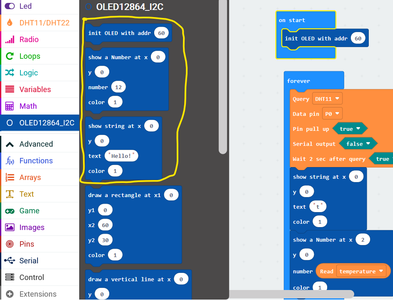

delete all you did in step 4

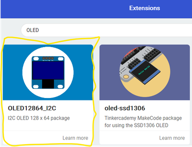

add the OLED extension
put a init OLED with addr in the on start leave it at 60 unless it doesn't work, then change it to 61
under query dht11 put a show string "t"
under that put show number "read temperature" MAKE SURE X IS 2
