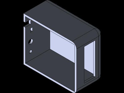

MOSTRADOR.STL is the box that contains a 16×2 I2C

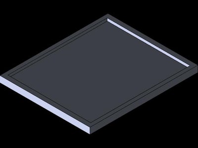

TAMPA.STL – It is the base of the box, where the arduino will be fixed.

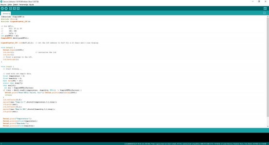

Step 5: Firmware Compilation Enter the Arduino IDE
First indicate the hardware (board) as being arduino nano.
Then search for SimpeDHT.h and LiquidCrystal_I2C.h libraries, include these in your ide.
Compile sensor.ino file in arduino IDE, and load in arduino nano.
Arduino IDE, already with the application
At the end of the compilation, something like this will appear.
Successful compilation process
Step 6: ​3D Printing
Now print the plastic parts, you can use the repository:
https://grabcad.com/library/box-arduino-with-displ...
The files for printing are as follows:
The display fixes the LCD display, finishing it.
The cover, fixes the plate.
Note that the drilling of the plate was not done on purpose, I recommend the use of a micro grinder for the best positioning of the holes.
