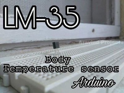

Hi friends Today we are going to build an temperature measuring circuit around Arduino UNO microcontroller using a sensor called LM35. So without wasting the time let's get started.

Step 2: Connect the Arduino
You may use the below schematic for making the connections to the arduino board to the LCD module
Even then I'll mention the connections to be made:
LCD RS pin to digital pin 12
LCD Enable pin to digital pin 11
LCD D4 pin to digital pin 5
LCD D5 pin to digital pin 4
LCD D6 pin to digital pin 3
LCD D7 pin to digital pin 2
Additionally, wire a 10k pot to +5V and GND, with it's wiper (output) to LCD screens VO pin (pin3). A 220 ohm resistor is used to power the backlight of the display, usually on pin 15 and 16 of the LCD connector.
