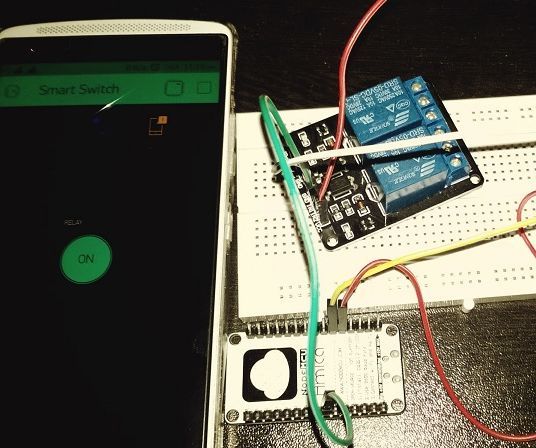

The NodeMCU collects the temperature and humidity from DHT11 sensor and sends it to Blynk app every second.

Step 2: Circuit & Connections
- D4 pin of NodeMCU connects to pin 2 of DHT11.
- 3V3 pin of NodeMCU connects to pin 1 of DHT11 & GND of NodeMCU to pin 4 of DHT11.
- 4K7 ohm resistor connected between pin 1 and pin 2 of DHT11 sensor.
- Connect power(3.3V) to NodeMCU to make it work without USB cable.

Play the app:
Click play button on top of your app and see your room temperature(degree celcius) and humidity(percentage) updated every second. Oh yeah!
