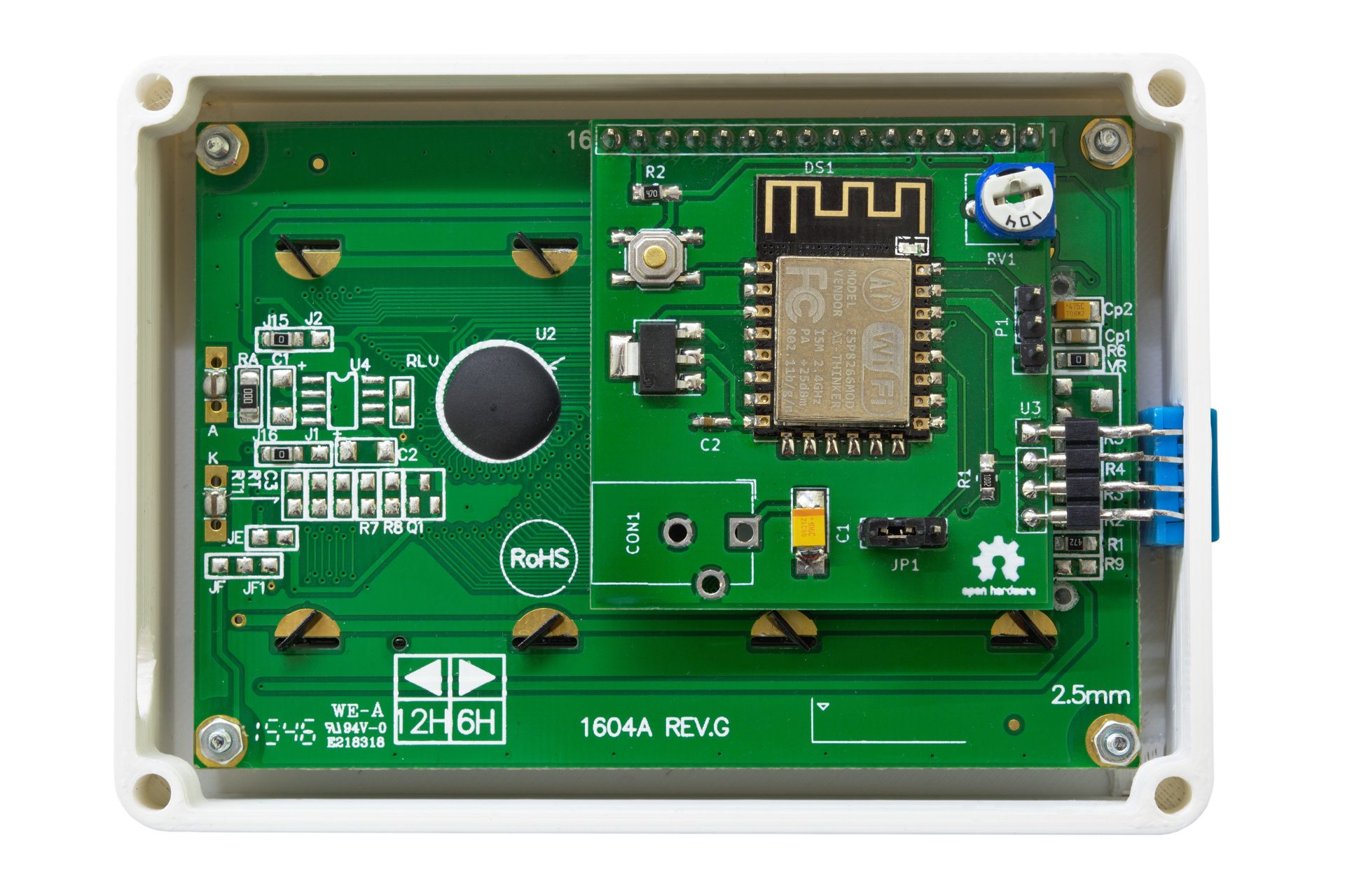

Step 4: Assembling the Monitor

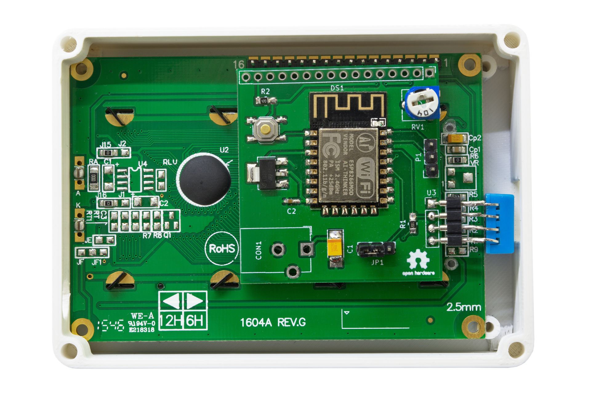

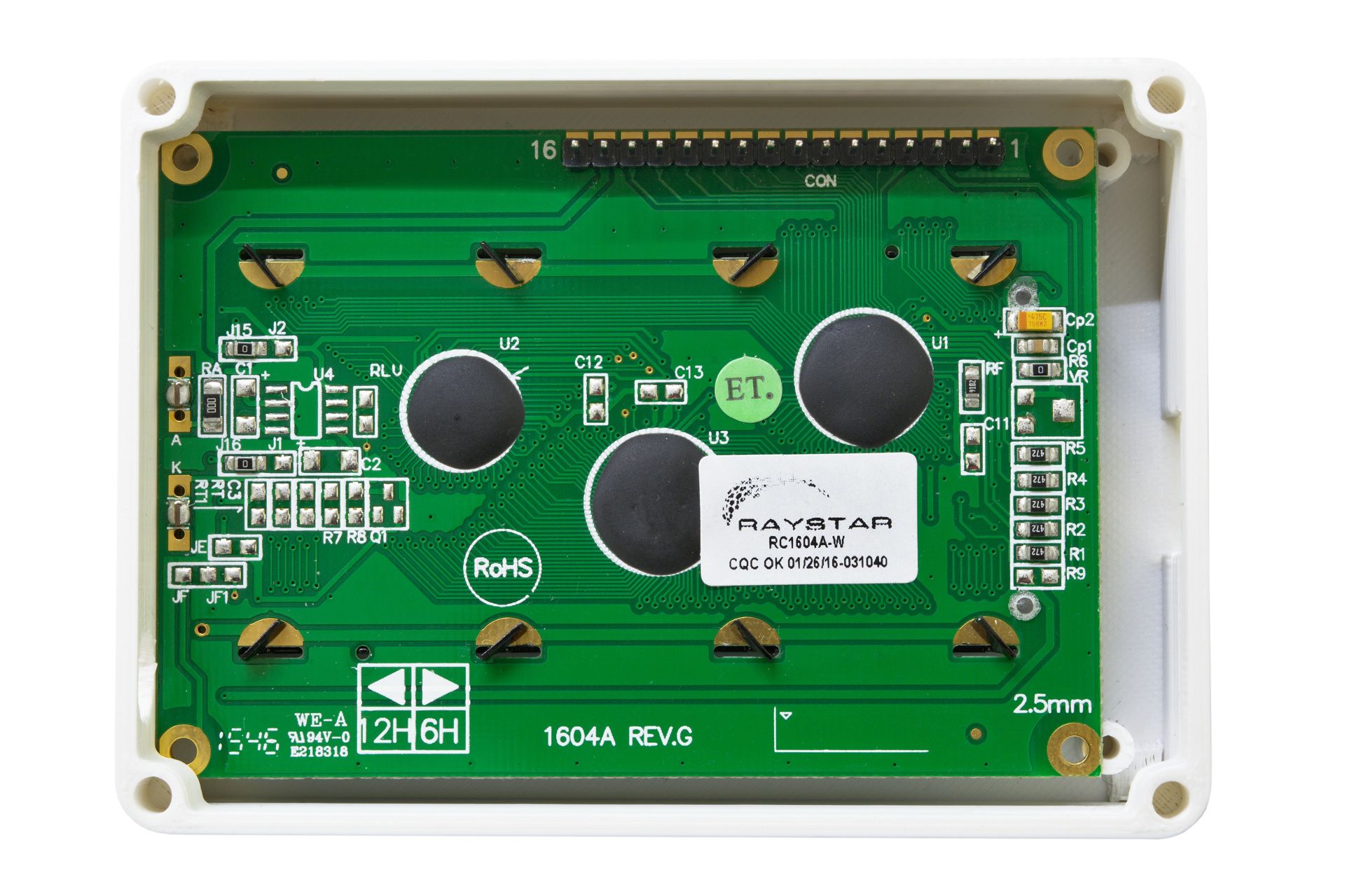

With the enclosure printed, time to put everything together. First, place the LCD inside the case and slide it to the left, so there will be a gap between it and the hole for the sensor.
Next, place the PCB on top of it, with the sensor already attached on the pin header.
After that, push the sensor into the hole, slide the LCD back to position and insert the PCB on the pin header. Now fix the LCD in place using M2 nuts and bolts, and solder the PCB on the pin header.

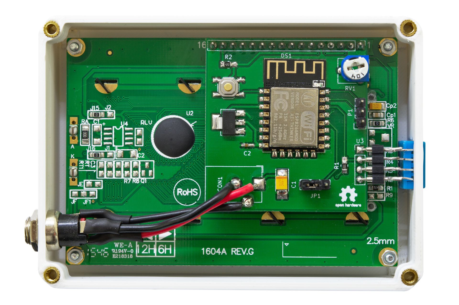

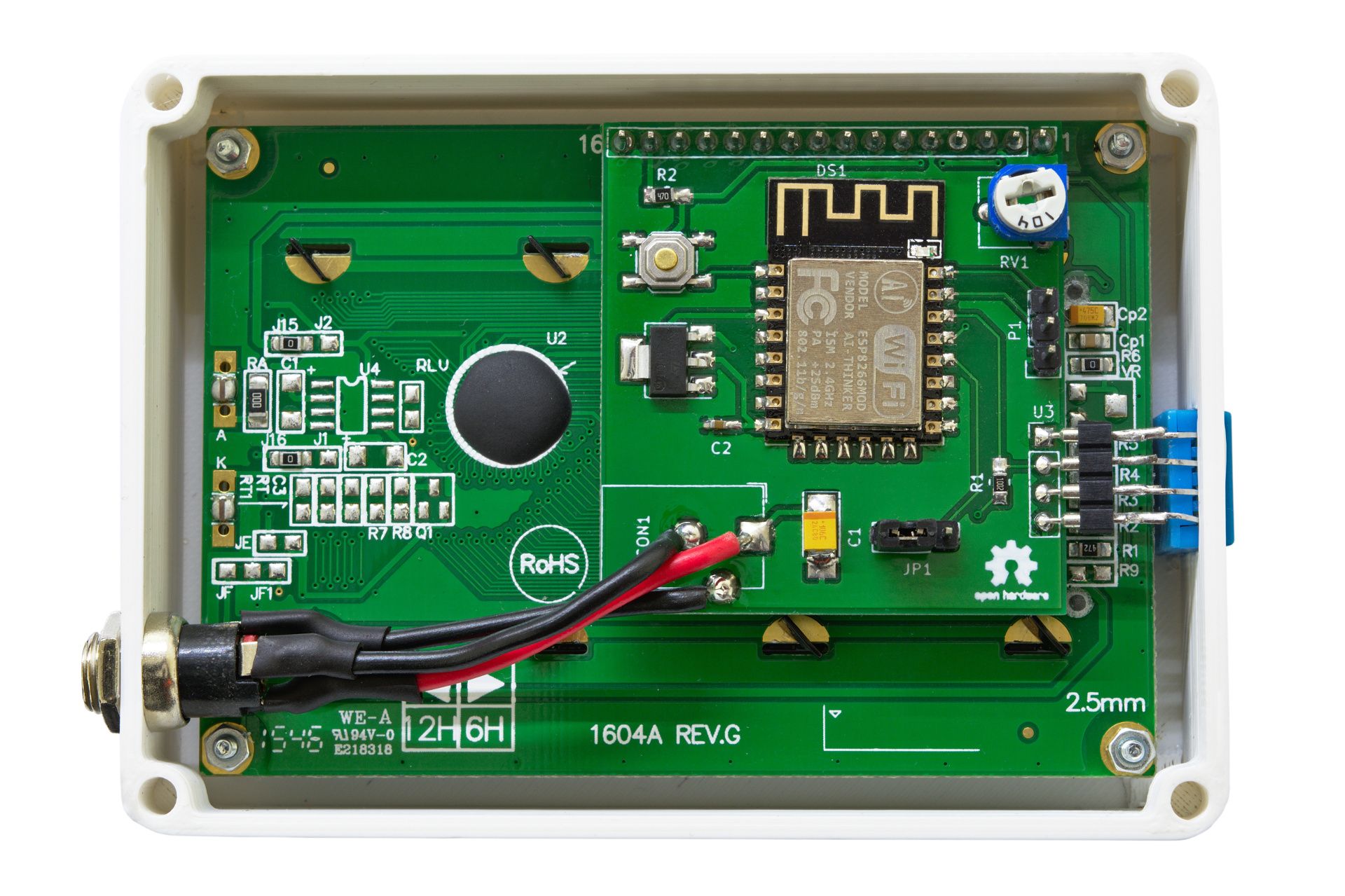

Next, put the power jack in place, attach some wires to it and solder their other ends to the PCB. The use of some heatshrink tubing here would also be a good idea.
Last step is to install the metal threaded inserts so the lid can be screwed in place with M3 bolts. For that purpose you'll need to use your soldering iron to heat them up, so they can be pushed into the holes. You can take a look on this instructable if you need more information about adding metal threads to your 3D prints.
