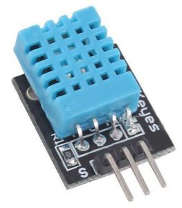

  • DHT11 temperature and humidity sensor

  1. Connect the VCC pin of the DHT11 sensor to the 5V pin on the Bharath Pi.
  2. Connect the GND pin of the DHT11 sensor to the GND pin on the Bharath Pi.
  3. Connect the OUT pin of the DHT11 sensor to digital pin 2 on the Bharath Pi.
