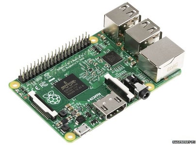

2. Raspberry Pi

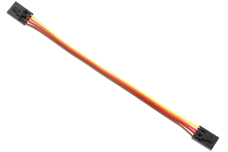

3. I2C Cable

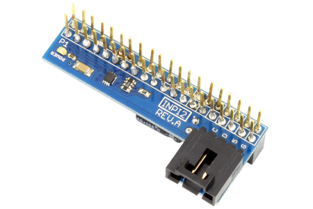

4. I2C shield for raspberry pi

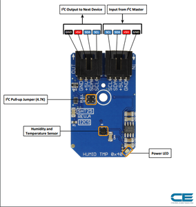

SHT25 I2C Humidity and Temperature Sensor ±1.8%RH ±0.2°C I2C Mini Module. It is high-accuracy humidity and temperature sensor has become an industry standard in terms of form factor and intelligence, providing calibrated, linearised sensor signals in digital, I2C format. Integrated with a specialized analog and digital circuit this sensor is one of the most efficient device to measure the temperature and humidity.

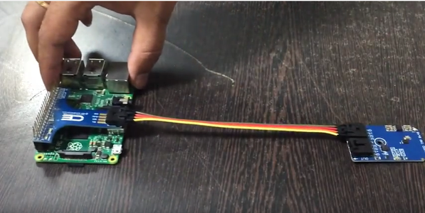

Step 3: Hardware Hookup:
The hardware hookup section basically explains the wiring connections required between the sensor and the raspberry pi. Ensuring correct connections is the basic necessity while working on any system for the desired output. So, the requisite connections are as follows:
  • The SHT25 will work over I2C . Here is the example wiring diagram, demonstrating how to wire up each interface of the sensor.
  • Out-of-the-box, the board is configured for an I2C interface, as such we recommend using this hookup if you’re otherwise agnostic. All you need is four wires!
  • Only four connections are required Vcc, Gnd, SCL and SDA pins and these are connected with the help of I2C cable.
These connections are demonstrated in the pictures above.

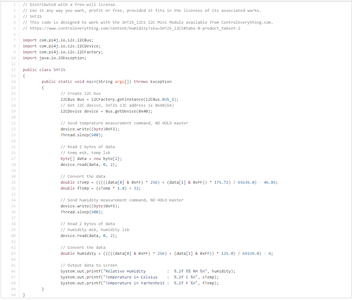

Step 4: Temperature and Humidity Monitoring Java Code:
The advantage of using raspberry pi is, that is provides you the flexibility of the programming language in which you want to program the board in order to interface the sensor with it. Harnessing this advantage of this board, we are demonstrating here its programming in the Java. The Java code for SHT25 can be downloaded from our github community that is Dcube Store.
As well as for the ease of the users, we are explaining the code here also:
As the first step of coding you need to download the pi4j library in case of java, because this library supports the functions used in the code. So, to download the library you can visit the following link:
http://pi4j.com/install.html
You can copy the working java code for this sensor from here also:

The output of the code is also shown in the picture above.
The library which facilitates i2c communication between the sensor and the board is pi4j, its various packages I2CBus, I2CDevice and I2CFactory help to establish the connection.

This part of the code makes the sensor operate for temperature measurement and humidity measurement by writing the respective commands using the write() function and then the data is read using the read() function.
