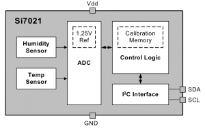

In this case we analyze the temperature SI7021 hand IcStation and humidity sensor. This sensor will be able to read both physical quantities, transform them into digital values and store them in your memory bank, so that when we ask through I2C one of the two parameters, the module will return 2 bytes that correspond to the value we are asking. As we see in the block diagram that provides the manufacturer of integrated SI7021 circuit, the circuit integrates an ADC to read the values of both sensors and send the reading to the logic block that handles calibrate and store the readings later when ask you for a value, the I2C interface to access the logic module, retrieve the value and return it via I2C.
As you may have been able to find out we will contact integrated through I2C for different bytes containing the values of temperature and humidity, if we analyze carefully the datasheet SI7021 see how each value is made up of 2 bytes ie 16 bits but through I2C we can only transmit 8 bits in a single response and therefore to convey the full value we have to get 2 responses.

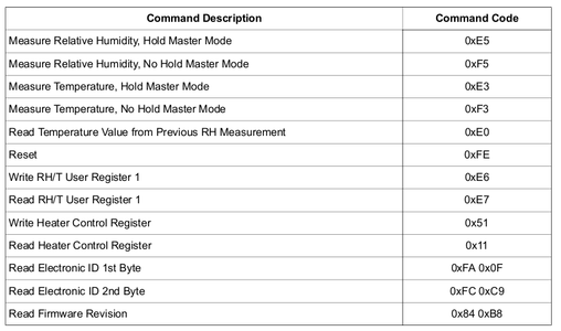

Obviously you have more integrated I2C we can send commands to obtain or modify different values and all of them can see in this table that provides the manufacturer of the component datasheet.
Table 2C command Source: Silicon Labs

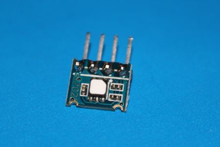

Remember that we are talking about a I2C device therefore
we have to use the corresponding pins of our microcontroller and if we are using the module does not have pullup resistors have to put them. If we look at the module IcStation carefully we see that already included on the plate the two resistors, so it is not necessary to include them on our own and also includes capacitor 0.1 uF you need integrated between Vcc and GND to stabilize its feeding.
A very important fact that you have to consider when connecting the integrated works is that NO 3.3v 5v

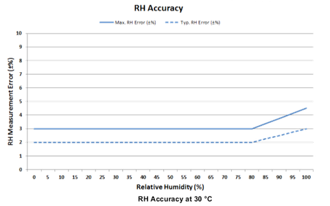

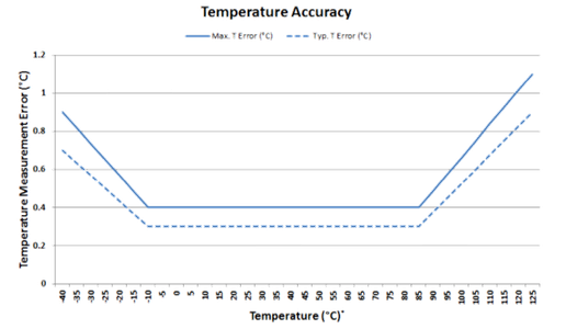

Precision
Let's talk about the accuracy of the readings and no sensor is perfect and always a mistake in this case will normally 0.4 ° C for temperature and between 2 and 3% moisture committed however these values are affected with the progression of readings and this variation we can see thanks to graphics that provides the manufacturer.
In both graphs we see that it is good enough for the applications that we will get to perform with this sensor except when we arrived at the extremes of temperature and humidity reading error increases. So we'd better choose the proper range.
