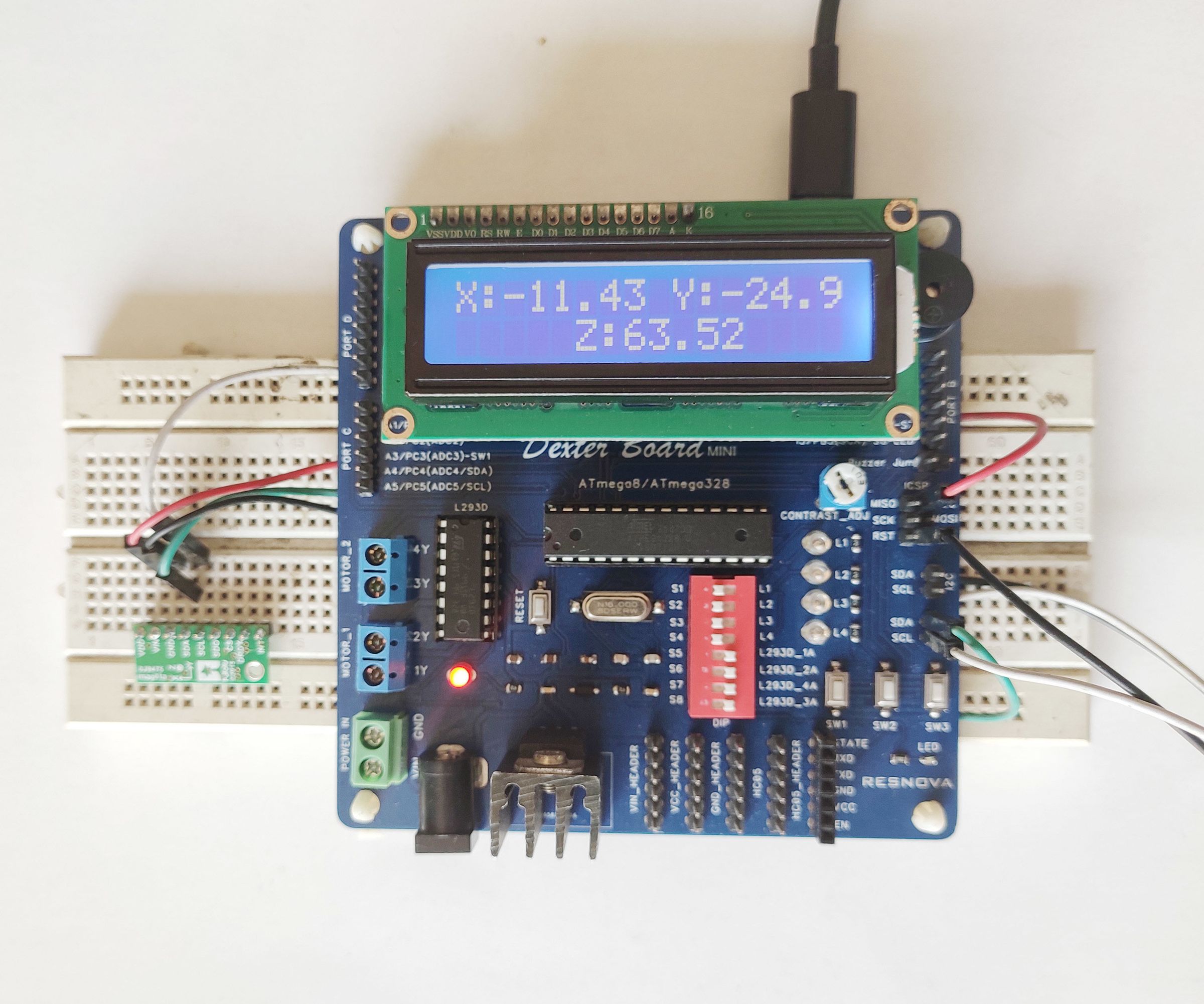

Step 6: Adjust LCD
If your LCD display shows nothing,adjust your LCD’s potentiometer You will get the output as in the picture
