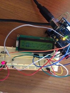

In my previous post, I have displayed the temperature on serial monitor. Today I will show you how to display the temperature from the thermistor to a 16x2 LCD WC1602A0. Yesterday I thought that my display is broken, but I have give him one more chance before give it away, and it was a shock for me to see that he is working.

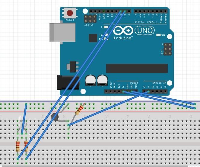

Step 1: Make the Connections
The connections are simple. Like in the image.
You will need a display, some wires, 2 x led, 3 resistor 560 ohm, one 10k resistor, a 10k thermistor, breadboard and arduino.

Step 3: Results
On the lcd you will receive the temperature and the led will be red or yellow, that depends of the temperature you measure.
red=hot
yellow=cool
