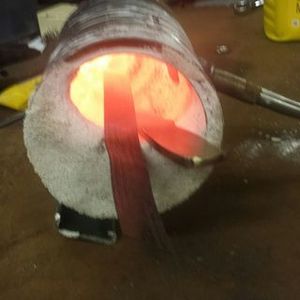

Step 1: Apply Heat
- Again I am not an expert at this so...... Don't get too bent out of shape if I'm not using proper methods. I recommend checking out https://www.instructables.com/id/Heat-Treating-Kni... for more detailed instructions and better techniques.
Soooo......
Step 1 is to heat up the oil we will be using for our quench. After doing some research this allows for an even cooling and helps to prevent bad stuff happening to the metal. Think boiling hot water on a car window in the middle of winter.
Step 2 is firing up the forge and heating up your knife as well as the scrap piece you will be using to warm up your quench oil. (Just warm oil is fine. 95 degrees or so.)
Step 3 The metal you are heat treating needs to be hot enough to lose its magnetic attraction. You test this by putting a magnet near it.
