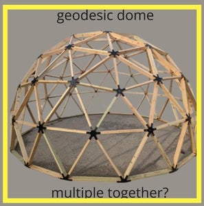

Step 2: Gather Ideas
The second step I took was to gather ideas. My two big ideas were a geodesic dome or a pavilion. I decided to choose the geodesic dome
Step 3: Choose an Idea
I decided to make a geodesic dome for this contest. I chose it because I thought that a pavilion was more of a permanent structure rather than being temporary.

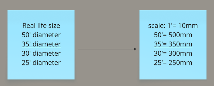

Step 4: Picking a Size
After I knew what to do, I needed to decide on a size and scale factor that I would use. The first thing I did was to figure out the scale factor I would use. I decided on a scale factor of 1ft equals 10mm. Next, I thought of sizes for real life. The sizes I thought of were 50, 35, 30, and 25 feet in diameter. The real-life size that I picked was 35 ft in diameter. The model will have a diameter of 350mm.
