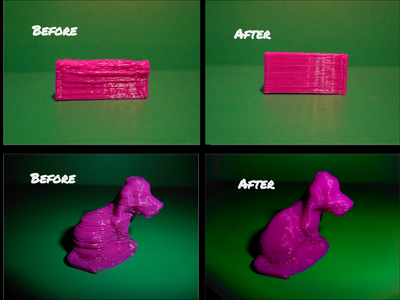

I have been pushing my Robo harder than usual in the past couple of weeks working on some projects that I wanted to enter in the Mind for Design and 3D Printing contests. Unfortunately, during this process, my prints started failing miserably! I was unable to solve the problem in time to print the prototypes for Mind for Design, so I have since been troubleshooting/diagnosing.
The next little bit of info will explain a little about diagnosing my particular print issues. If you just want the fix, without the fluff, feel free to jump ahead to Step 1!
There were a couple of things that made diagnosis tough. First of all, the inconsistency in the failures. Sometimes it would just quit, other times it would skip layers and sometimes it would keep printing, but the Z would not move up, resulting in a smushed-up, globular mess! These fails (some quite epic, I might add!) seemed to occur without rhyme or reason, varying heights and varying times. Second of all, while researching this issue, I found out there could be numerous causes for such failures. And, wouldn’t you know it, a majority of the possible causes were all relevant and coincided with the unfortunate timing of my printing problems!
Some known causes of these types of failures include:
  • Power Surges-These can be caused by a new appliance recently plugged in or working harder, drawing from the power supplied to the printer. I had just plugged in my window AC for the first time this year. Tried turning off the AC-no luck! Also, my printer is on the same circuit as my refrigerator, which is working overtime now that it is warmer. Tried switching outlets-no luck! Ruled out power surges.
  • Recently added Hardware or Software-Obviously, adding new things to your computer can make strange things happen! I had just gotten a new cable modem. Tried disconnecting the internet-no luck! I had also recently installed a few new design programs. Uninstalled those-no luck! Ruled out new hardware/software.
  • Firmware Updates-Occasionally firmware updates have bugs that are not quite worked out. I had literally just updated my firmware, so I uninstalled it a reinstalled the previous version-no luck! Ruled out firmware updates.
  • Computer Interrupts-Sometimes “handy” features like automatic updates and start-ups can cause misfires in your printing. While I hadn’t had any issues with this in the past, perhaps a new automatically installed update to my start-up or running programs was sucking some of my pc usage. Manually went into the control panel and disabled automatic updates and shut down unnecessary running programs-no luck! Ruled out computer interrupts.
  • Problems with the Z rods-Now my Z rods have been a bit wobbly and occasionally squeal, but upon recommendation on the Robo 3D forum I have been using 3-n-1 oil to keep them lubed up. Perhaps they were getting too gunked up causing some binding. Cleaned them off, applied a new, thin coat of 3-n-1 machine oil-no luck! Ruled out Z-rods.
  • Bad USB Connection-USB connections are (as I recently discovered) notorious for causing print problems. Changed USB cords-no luck! The USB connector port on the Robo 3D R1, is a bit weak so I tried securing it-no luck! Now, I bet you’re guessing I’m gonna say I ruled out USB, but no, actually, I still thought this could be an issue! Surprise twist! So, there was one more thing I could check.
  • Overheating Stepper Motor Drivers-The new Robo 3D R1 has a small fan mounted directly below the Ramps Board on the newly added bottom cover of the printer. This fan has been known to burn out. So, I decided to kill two birds with one stone here. After watching a great tutorial by Barnacules Nerdgasm on YouTube (make sure to read his video description for a discount code) I ordered an XXL Smart LCD Controller from PrintedSolid (this would eliminate my need for a USB tether!) and decided as soon as it came in I would flip over the printer and remove the bottom to check the fan and install the LCD. Eureka! The fan was burnt out! Which now takes us back to the simple hack to keep printing until a new fan arrives!

With the feet and fan in place I had 3 successful prints in a row! Before this hack, I couldn’t even get one! Great big sigh of relief. Now, I just have to wait for my new fan, but, luckily I can keep printing until it does. And, of course, I should print some feet-but now I kind of like the looks of my Lego feet, so, I may keep them! And-while I still need to do a bit of fine tuning after all of the adjustments and jostling-I’m happy!

Also, I'd like to give a shout out to MustangDave who created that adorable little puppy in my before and after shots. I printed the full size model for my Mother and it came out awesome. So, now I frequently use it, scaled down, for tests. The model in the photo is scaled down to 30%, so it does lose a little detail, but it is a wonderful scan and prints beautifully.
