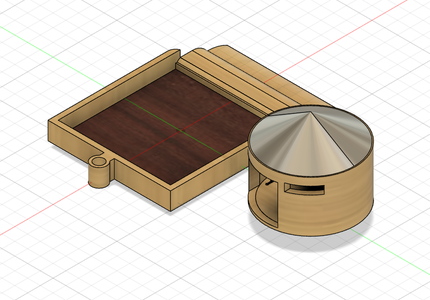

Introduction: Temporary House With Trailer
We made a compact temporary house (Model) with wheels as well as a trailer bed for transporting it.

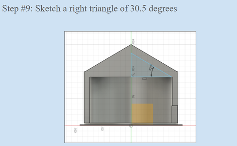

Step 9:
Step #9: Sketch a right triangle of 30.5 degrees
Step 10:
Step #10: Revolve the triangle to 360 degrees
