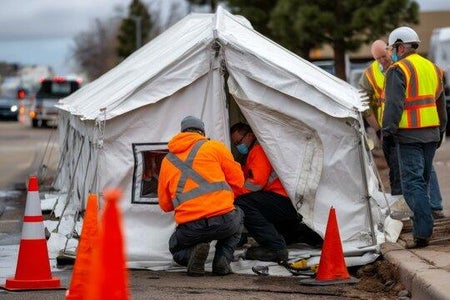

An easily-deployable emergency response shelter has always been a necessity in times of civil unrest and natural disasters. From hurricanes and floods to protests and war-torn cities, an emergency response shelter can be deployed in a wide variety of different scenarios to support victims and provide aid to the surrounding population. However, historically these shelters have been hard to transport, difficult to set up, inefficient at providing care to a larger group of people, and extremely expensive. With this project, I aimed to design a temporary emergency response shelter that could operate efficiently, be easily transported and deployed, and be cost-effective.

Step 1: Research
To start out my research, I looked at images of emergency response shelters used in past natural disasters, including the American Red Cross Shelter in South Florida and the Pasco County Shelter for Hurricane Michael victims. I learned about what kinds of materials, equipment, and staff are typically needed to run such a shelter, and what kind of conditions they are usually deployed in. From my initial findings I made a list of project requirements to guide me through the design:
  1. The shelter must be easily transported by truck, plane, and boat
  2. The shelter must be able to be quickly and simply deployed by the medical staff
  3. The shelter must be able to treat a large number of people in a orderly manner
  4. The shelter must be able to withstand harsh rain, temperatures, and other natural phenomenon
  5. The shelter must be inexpensive to build, and easy to maintain
With those basic design principles in mind, I started out with a basic outline of the emergency response shelter.
