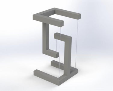

Step 4: CONCEPT
The concept behind this piece of furniture is simple: the upper frame is hung from the lower one through a chain and the 4 lateral cables have the purpose of stabilizing the structure, which otherwise would be in a situation of incipient motion.
The two frames are perfectly identical in shape and size, the only variations are represented: by the feet present in the lower frame only and by the tensioning devices in the upper frame only, in which they will be hardly visible as they are hidden by the wooden top. The frames are made up of a square box of 30mm and 2mm thickness, shaped as per the attached sketch.
The 4 side tie rods are ø1.5mm bicycle brake cables, guaranteed for a load of 40kg each and will need to be pretensioned for about 20kg. To make sure that all cables have the same voltage just pinch the cable and listen to the note produced, you can also help yourself with an app on your mobile phone, which indicates the frequency (Hz) of vibration. For your curiosity you can also evaluate the traction on the cable: https://www.spaceagecontrol.com/calcfunm.htm?MA%5...
The central chain, when the cabinet is unloaded, will therefore be subjected to a traction of 80kg (20kg x4 cables) and therefore cannot be identical to the side tie rods. When the piece of furniture is loaded, the traction on the central chain remains unchanged while that on the tie rods decreases.
