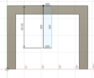

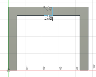

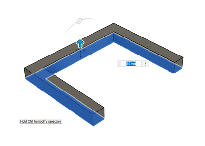

Create a new sketch, and copy the shape in the first image. When completed, extrude the shape by 10mm (0.4 inches)

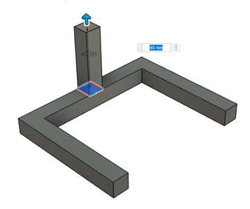

Create a new sketch on top of the base. Create a 10x10mm square in the centre of the back beam, and extrude it by 40mm (1.6 inches)

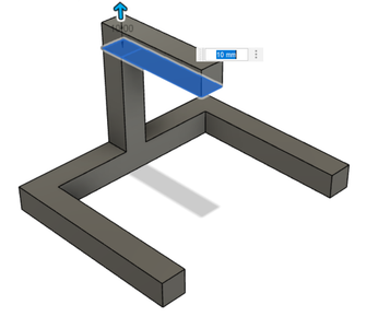

Create a new sketch on top of the hook base, and draw a 10x40 rectangle. Extrude this by 10mm (0.4 inches)

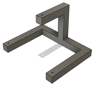

Create a 2mm circle on all 3 beams, and then cut them from the body. These holes will be used to tie the string/wire to the structure after printing.

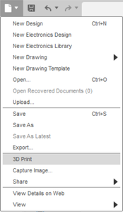

Go to file -> 3D print, and then click the body and press OK. Save the .stl file to a location of your choice.

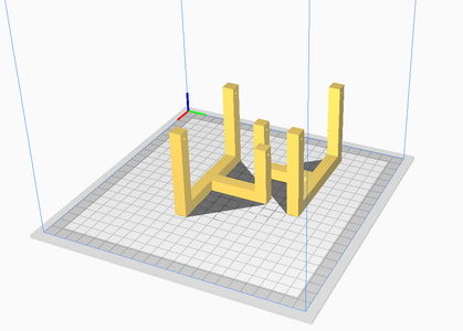

Open the 3D printing software you are going to use, and import 2 instances of the .stl file you created. Apply the settings of your choice, and export the file to your 3D printer.

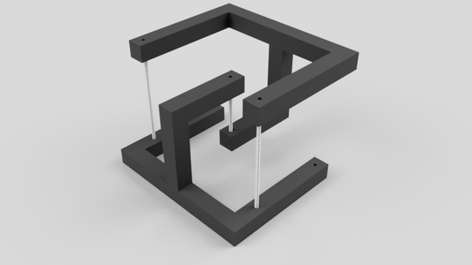

Use your string/wire of choice to connect all the parts to each other. I would recommend using fishing line, as it is both thin and transparent, making it hard to see. This will give the illusion of the top part floating.
Step 10: Done!
Congratulations! You have just created a tensegrity structure. When it is in action, the structure should be able to hold a bit of weight before collapsing. Enjoy your creation, and use it to blow some minds!
