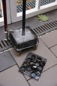

I decide to made a stove for 16pc 35mm diameter tea light.
In the store I found a metal bread baskets which is the perfect dimension for the candles. Why baskets? It will serve as protection from direct contact heat transfer from the stove surface (up to 160 C) with the tent, sleeping bag, blankets, fabric etc.
For the stove I took a big can from the scrap yard, and cut out a metal sheet 0,35mm thickness. Bent it into two equal boxes - bottom and top. Inserted a tube (chimney tube adapter).
The idea was to have a central chimney which can eventually serve as the central tent pole in my (KP teepee) (Tipi tent) - later I abandoned this idea.

Satisfied with previous test run, I finalized the stove.
The chimney was shortened, and only attached to the top box. Now the exhaust is 20 mm in diameter. I should get a better draw because of this.
I mounted 4 wooden legs on each side of the lower basket and built a door for sliding a small plate (drawer) of candles made out of perforated metal sheet. The chimney was attached to my hiking pole which serves also as central tent pole.
Looks very nice....
Fully loaded the test started perfectly.
For 2 hours I left it unattended. And suddenly smoke - the wax start burning!
The flame was very difficult to extinguish - what happened?!?!
As a fireman after a disaster, I collected facts:
  1. Temperature in a box was so high that IR rays reflected down and ignited the wooden leg which started an open fire under the candles! You can see the result in the pictures. Imagine that in the tent ... back to the beginning !
  2. No more wood near/on stove
As shown on the last picture, I inserted 4 long 16 cm screws, divided with nuts, through the box which serve as legs making the distance from the ground 8 cm. They also connect two halves of the stove together...
