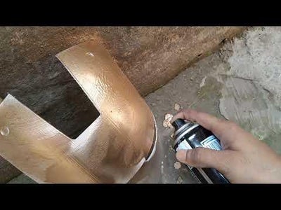

Step 2: Polishing and Painting
Once the mask was off the printer, I gave it a quick sanding to smooth out the print lines. Don’t skip this step—it makes a huge difference in the final look. I started with medium-grit sandpaper and then moved to a finer one until the surface felt smooth to the touch.
After that, it was time for paint. I chose a golden metallic spray to give it that robotic, machine-like finish. A couple of light coats worked best—spray evenly, let it dry, and then go over it again until you get a nice shiny metallic effect. The paint really brings the design to life and makes it look more like a piece of futuristic tech than just a 3D print.
