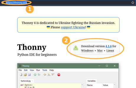

Step 2: Installing Thonny IDE
Now that we've covered how it works, we're ready to get started!
Visit thonny.org to download Thonny. Simply follow the installation instructions for your operating system.
