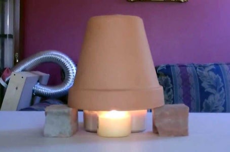

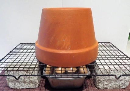

The original flower pot heater setup that came out years ago used 2 nested terracotta flower pots held together by a metal screw, nuts and washers. The pots sat on bricks with lit candles on a bread pan. It seemed to work but looked like it was OVER-KILL to me.

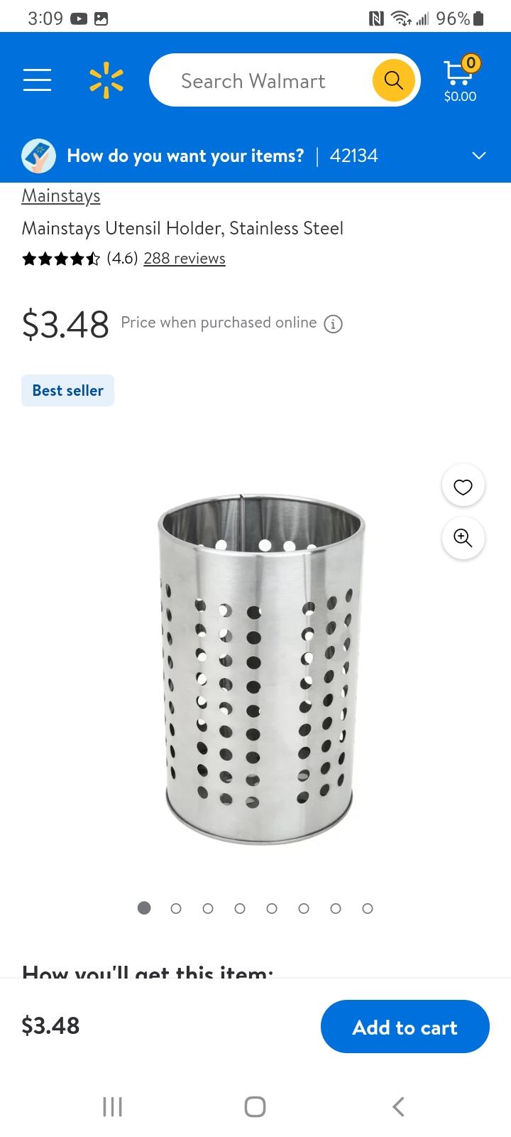

Mainstays Utensil Holder, Stainless Steel (found at Wal-mart)

Step 1 – Buy the utensil holder first.
Step 2 – Take the utensil holder with you too Home Depot and take it into the garden dept with the receipt where you bought it.
Step 3 – Start to match the right pots and plates to the utensil holder width and height.
Step 4 – The wonderful part about this heater is there are no bolts to buy and screwing things together. It is SIMPLISTIC in design. No tools needed.
