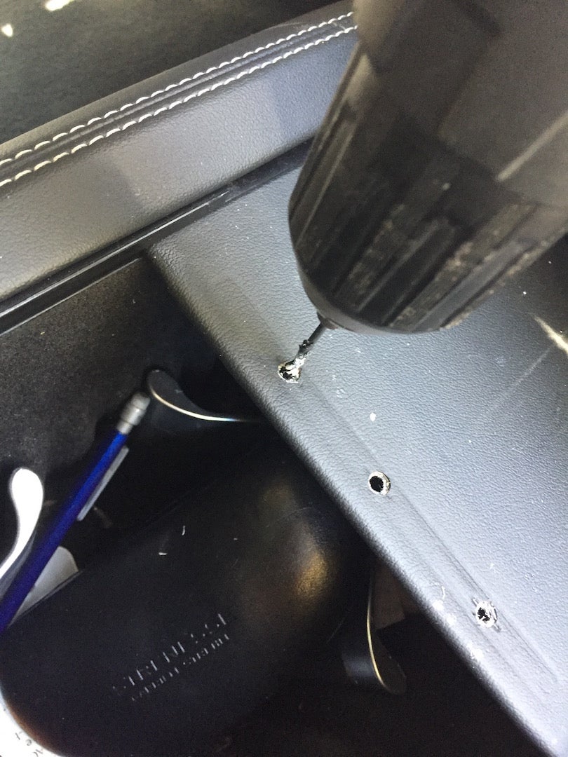

Step 1: First Thing - Carefully Separate the Old Handle From the Sliding Cover
and then rip off the plastic underneath. you can replace this with longer screws if you want to keep the latch - but i don't see a reason.
the original fastener is shown. it does not have a screw head - instead it appears to be pushed in like a rivet. i don't think you can remove the original fastener.

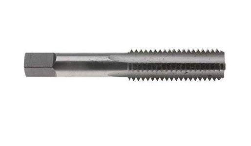

Step 2: Use a 3mm Bottoming Tap to Retap the Holes
Telsa used some kind of cheap sheet metal screw. When I took this apart there was enough handle left to tap it out.
use a bottoming tap, i did not have to redrill the hole - just ran the tap in. clear the threads every few turns.
