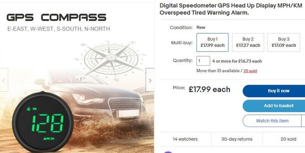

- A very low cost digital display that comes in an neat hemispherical pod.
- It contains its own GPS satellite sensor and so all you need is to supply power and it will work.

1) Generic GPS speedometer display. There are several types but the one I used has a round binnacle (see images).

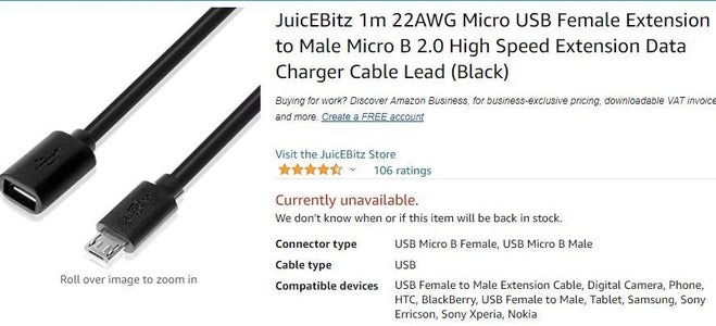

2) 1 metre long micro USB extension cable, i.e. micro-USB male at the end connecting into the speedo module and female micro-USB at the other end into which the wireless power receiver coil will plug. This cable will run inside the air vent and then down behind the central screen so you end up with a very neat result.

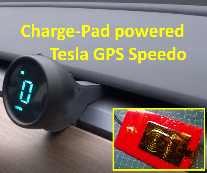

Step 1: Decide How You Would Like to Mount the Speedo Binnacle
I glued the binnacle to a 3D printed holder. This holder gently clips into the air vents as shown. As the binnacle is so light it will not move around as you drive.

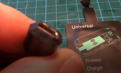

Step 3: Prepare Female End of Extension Cable
The plug on the wireless power receiver coil is very small and flimsy. To get it to insert into extension cable correctly you need file or very carefully grind away the plastic so the end of the metal part of the female micro-USB socket on end of the extension cable is protruding with no rim of plastic in the way that might stop the plug on the end of the receiver coil being inserted fully. Insert the two together when you have done this.

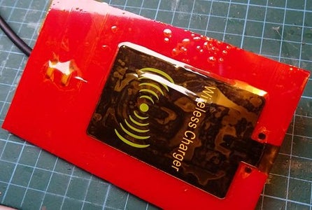

Step 7: Sticky Plastic Film
Apply adhesive plastic film or tape as shown here then ideally wrap it over the base of the plastic slab phone substitute, so it runs up the other side, also then holding in place the receiver coil. This is quite tricky to do neatly. Notice how the end of the plastic has been filed to allow the ribbon cable to curve around and plug into the end of the extension cable without too much undue stress being applied to this very fragile assembly.
Step 8: Stick Down the Receiver Coil
Wrap the adhesive film around so it also then holds the receiver coil in place.

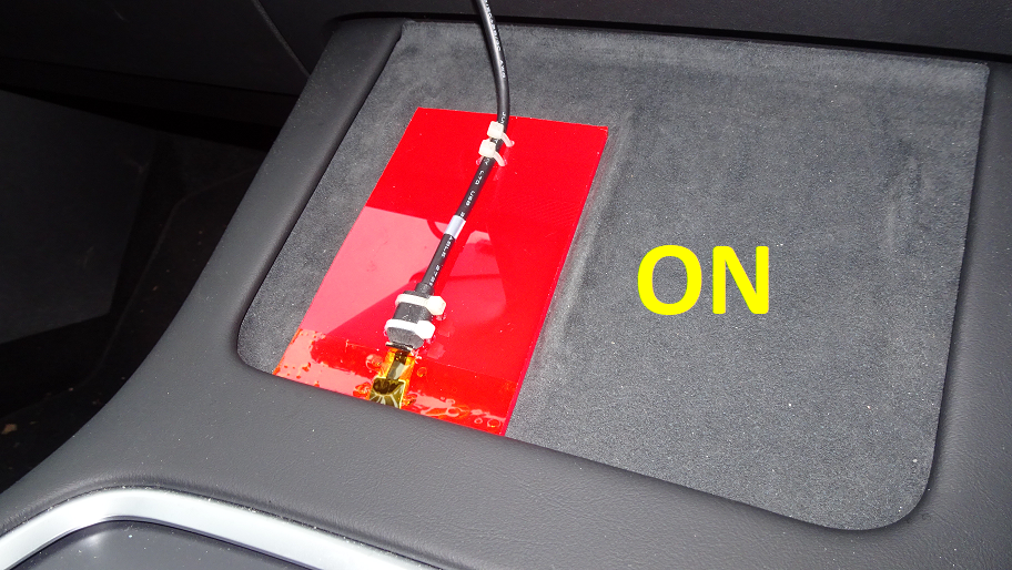

Step 13: How to Turn It on and Off

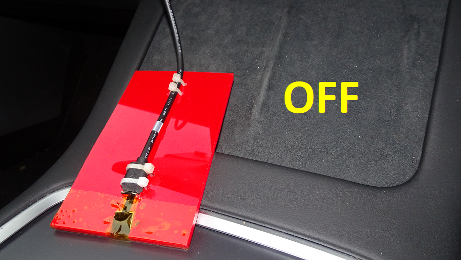

Turn it off by NOT placing the coil on the charging pad in the car.
Step 14: Turning on and Off
To turn display on you just place your imaginary phone onto the charging pad of the car. The cable (see earlier photos) can be run along to the speedo display inside the upper ventilation slot so you cannot see it.

I assumed when I parked the car the charger pad would automatically turn itself off so the speedo would just come on and off automatically when you drove the car. This does not seem to be the case, when I exited the car and locked it the pad carried on powering up the imaginary phone. So, to turn off the speedo you do need to just move it slightly away from the charger pad when you park the car. This is still way easier than plugging USB extension cables in and out of fiddly sockets, it is neat and it keeps the main centre console unobstructed by any wires.

Step 16: Enjoy!
It seems to work very well.
