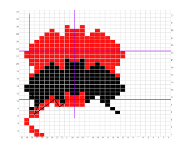

I decided on a bat motif, as I wanted to work on a relatively small scale, which with knitting rules out curvier shapes. I started experimenting with a basic cell, mirrored it, and then decided it would add interest to have a column of right way up bats, followed by a column of upside down ones.
Step 2: Converting to Knitting Chart

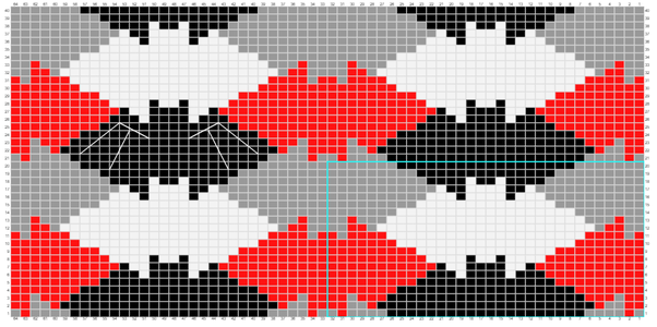

After I'd come up with a rough design, I held the paper version in front of my computer screen, and traced the outline onto a grid (with intarsia, the type of colourwork used here, the 'pixels' are not square, because each knitted stitch is wider than it is tall. I used charting software called Stitchfiddle which allows you to enter your vertical and horizontal gauge for design work: this is why my pixels look rectangular).
I then continued playing with the design, duplicating and flipping the prototype until I had a design that tessellated perfectly.
Step 3: Swatching
In order to work out how many repeats I needed to make a cowl, and to test my pattern, I knitted a swatch using one full repeat of the pattern and two selvedge stitches on either side, then measured it.
I got a gauge of 16 horizontal and 25 vertical stitches per 10cm, and based on this decided to cast on 164 stitches: 5 full repeats and 4 selvedge stitches.

I then embroidered the wings onto each bat according to my diagram, and gave the black and white ones fangs, plus I embroidered French knots on the white ones for eyes. I decided to add the beady eyes for the black bats after blocking, as I planned to steam block and I didn't want to risk damaging them.
