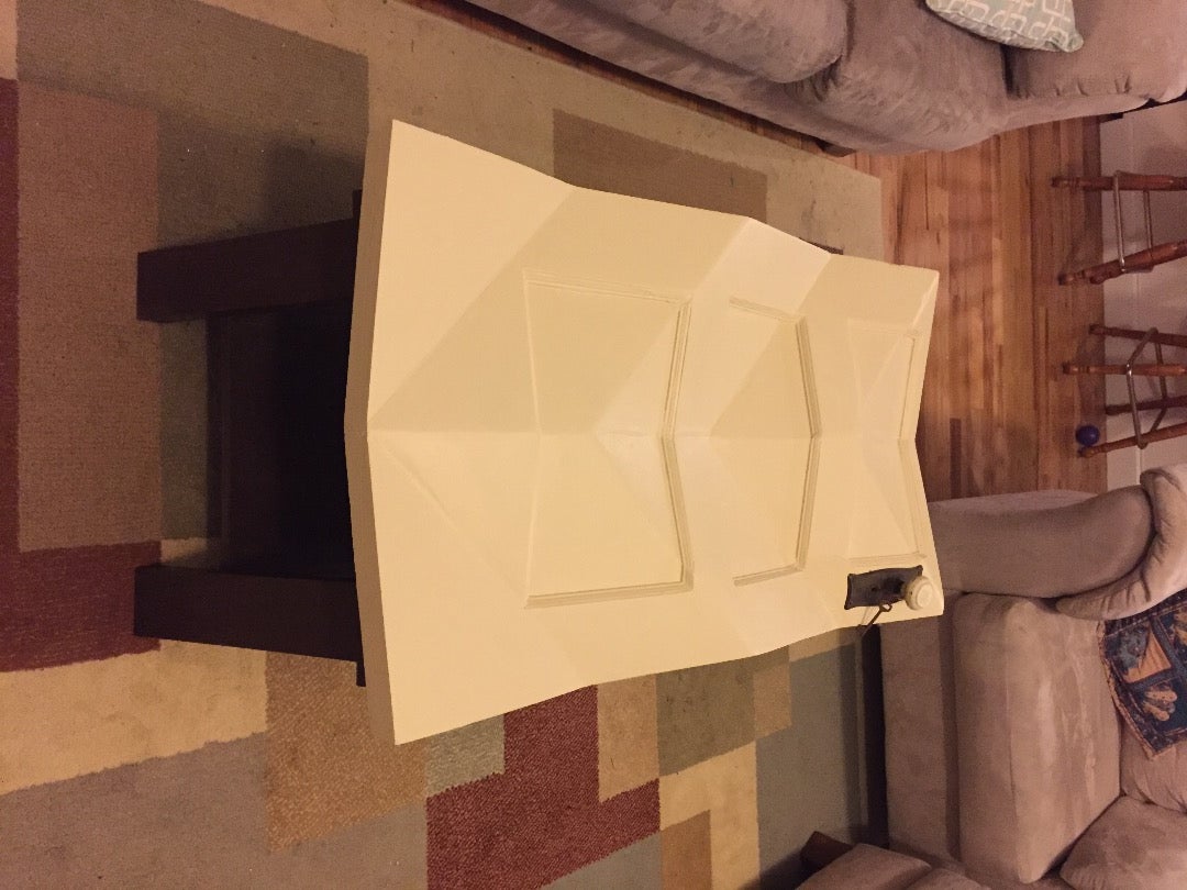

Step 1: Can I Make a Small Scale?

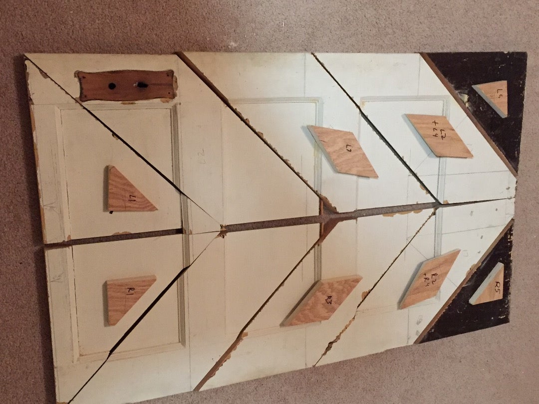

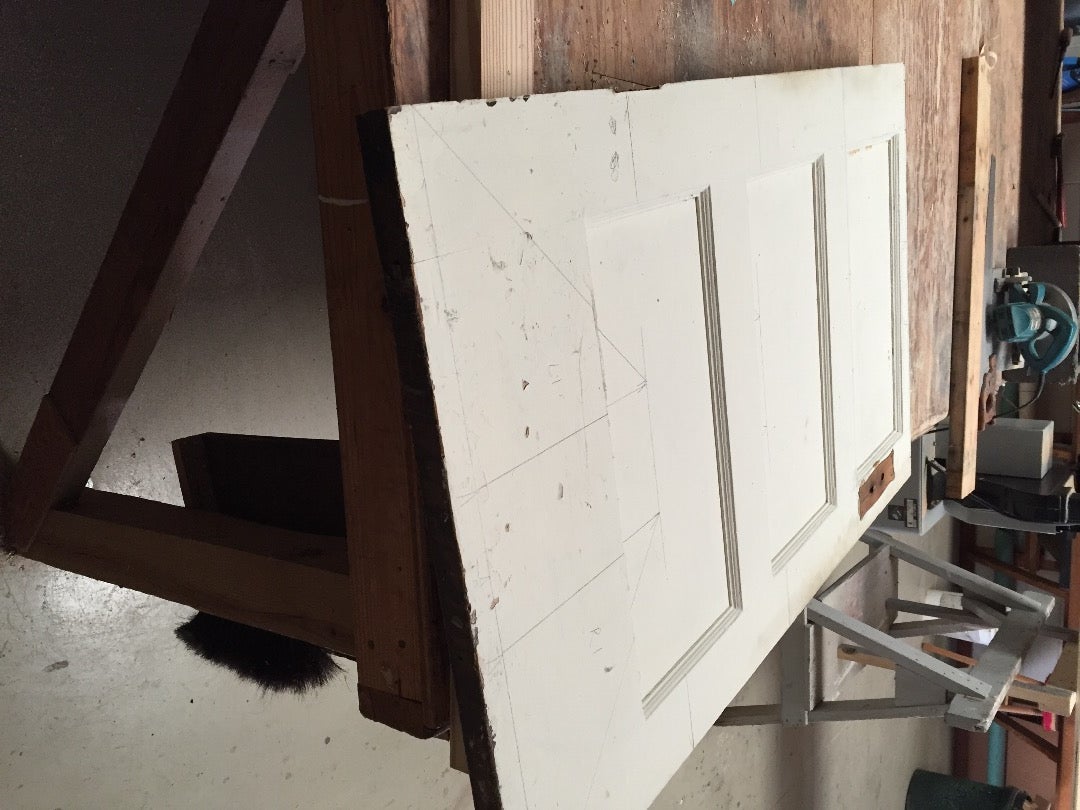

I figured that I have one door and one chance. So to make sure that I don't screw my door up, I made a mock up. And I am glad that I did.
The door started out 80"x30". My finish table top will be 24"x48". To get the ends to be right, I had to cut the middle six out. I did not realize this until my mock up.
I labelled all of them from the bottom up. Started with L1&R1. The Angles that I used is 13degrees.

The flip flopping of angles was hard to do. It was a lot of turning around on a chop saw. I started out with eight feet by four feet of three/quarter plywood. It was not enough. Between the missed cuts and "dangit" wrong angles. I ended up using about sixteen feet.
Step 2: Cutting Up the Door!

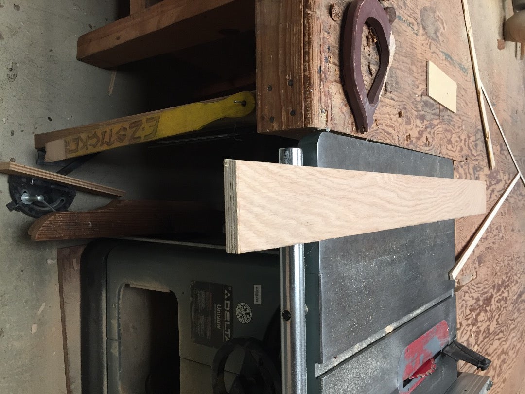

The things I used most was a Compound Mitre saw and a table saw.
Start off with the table. I wanted to save as much as possible in case I needed some uh'oh material. I ran it on the cross cut down to thirty(wide)x48(tall). Making sure to keep the mortise for the knob.
The know would be a big selling point to keeping the door theme.
Next, Split it down the middle. then I had two pieces 15x48.

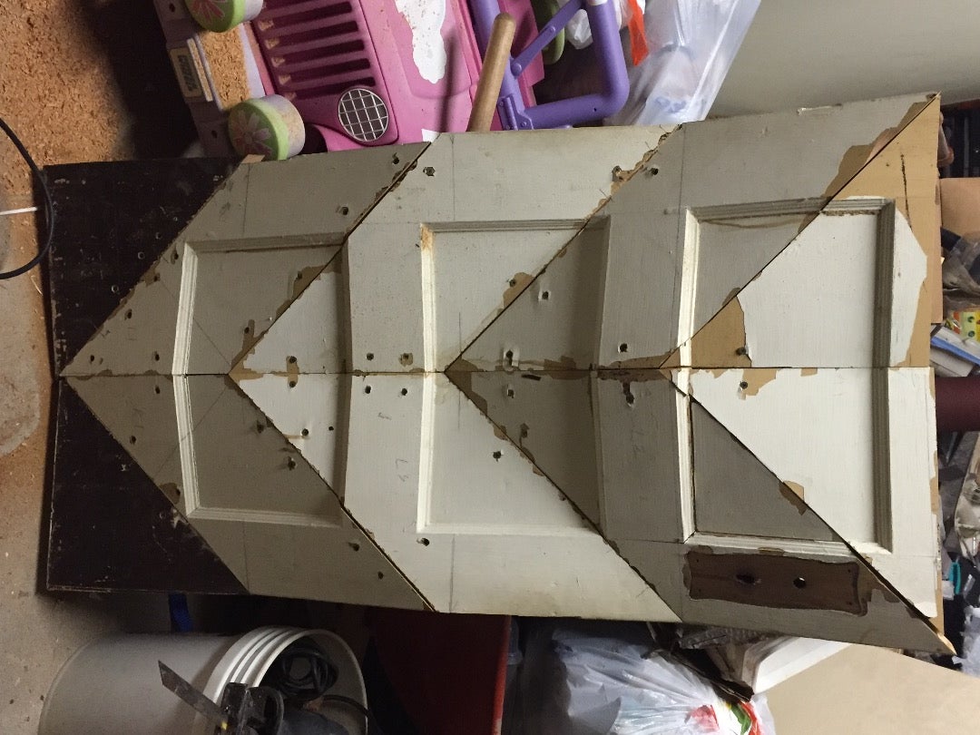

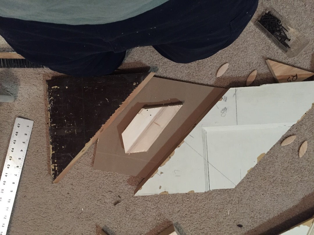

Now to the Chop saw?
Being 12" square, the hypotenuse is longer than my chop saw. This makes my cutting a little more precarious.
Either way, I stick to the plan. I use my mock to check all my angles. No room for missed cuts. If each panel is to line up. No pressure????
Whatever!! It worked.

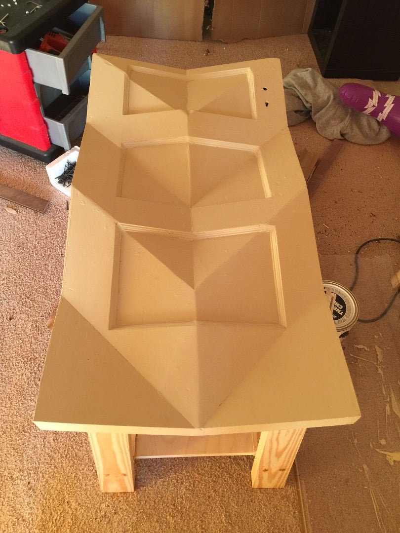

Step 3: Biscuits, NO Gravy?

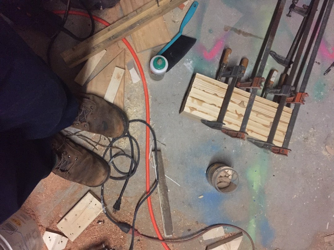

Joinery and Glue.

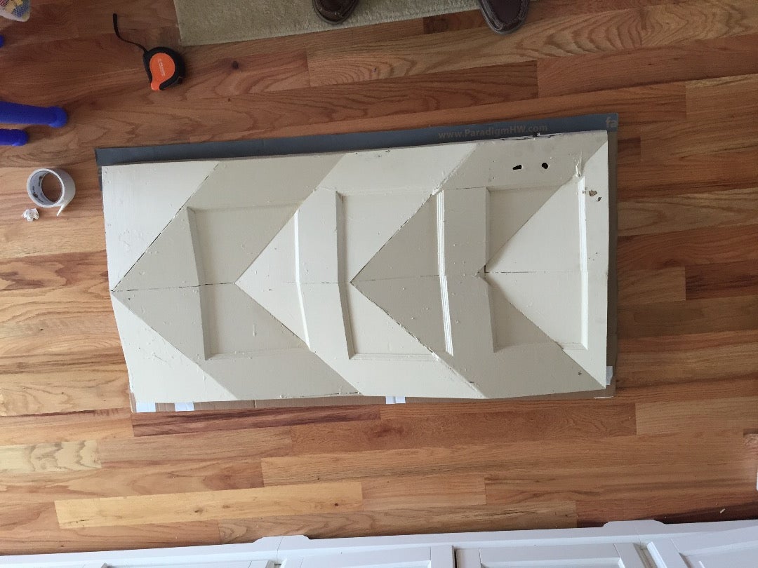

The first pic is my biscuit jig. It keeps allof the angles and facing lined up.
I always thought the cutting of the door would be the hard part.
The second pic are the boards with 13 degree angles cut on them. This will serve to mount and screw the door up while the glue hardens. Clamp jigs that I made up sucked!!!
The best thing was to line up the left and right first. then glue up to the big mast.
There was a few gaps and offsets along the way. Nothing that a little wood glue and saw dust couldn't fix.

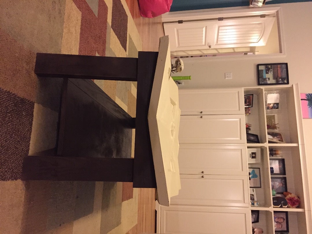

Step 4: Making the Table
The Table needs to be topped out at 19 inches. the door is 3 inches in girth. This gives a rough table of sixteen by 48 ish. It also had to have a bottom shelf.
I won't bore you thru all the details. The top part is made of white pine. The legs are doubled yellow pine one by four on a 13 degree angle. I thought this would accentuate the top a little. The shelf is yellow pine also with plywood in the middle.
The hard part of this was getting the apron to fit tight under the crooked part. The best jig I could come up with was a two inch offset marking scribe. This set off all the angles. Then I cut on a bandsaw at a thirteen degree angle all the way. It didn't hve to be, but it can't be seen and makes it all tight with no problems.

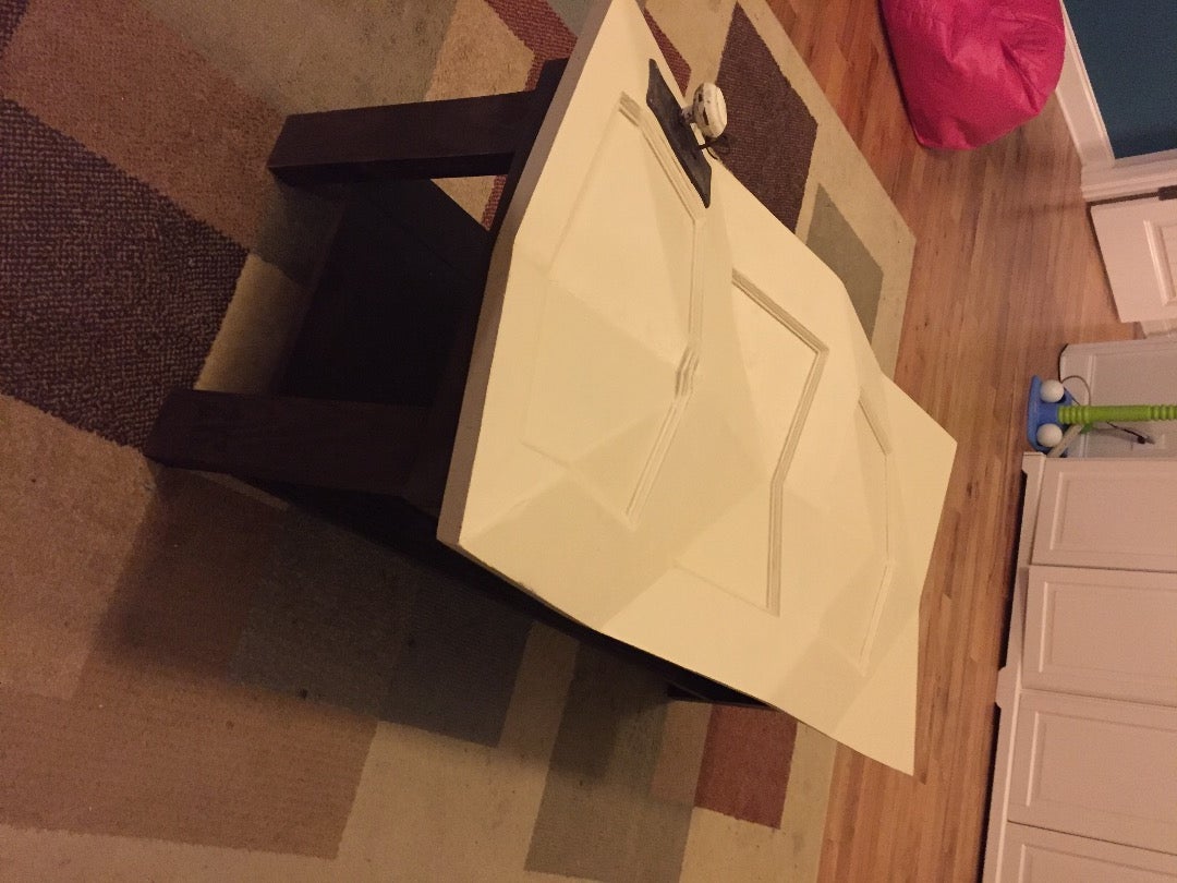

I then sprayed the table, and brushed the top.

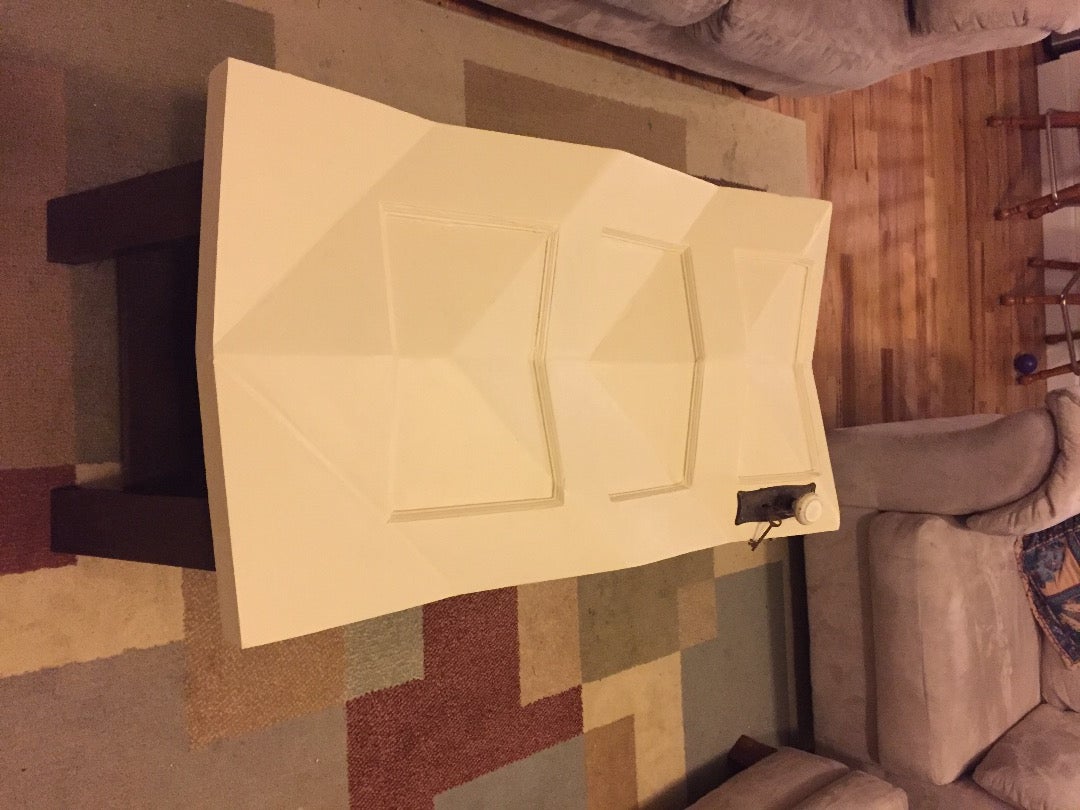

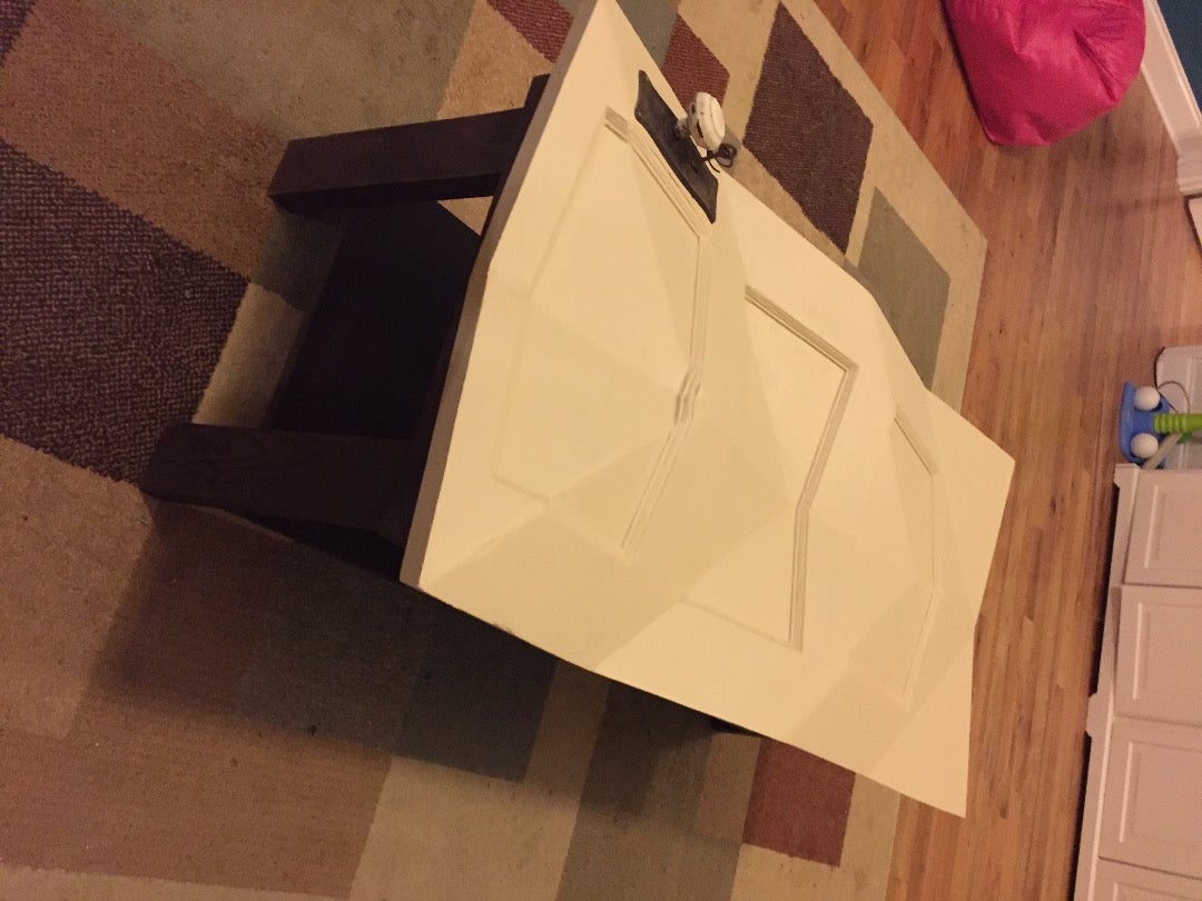

Step 6: More Glory Shots!!
Hey! It took me two months. Let me show off my hard work. Thanks for looking, and sharing, if you did.

The table has six exact same trapezoids with contrasting side angles.
And four halves of the same trapezoid. Confused? A Tessellation? Seems like it to me.
Also, is it an optical illusion? I took a lot of pics of the table. I intentionally used the ones in this ible that distinctly showed all of the shape and angles.
