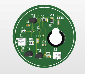

Step 1: Working
When you connect the component which you want to test with the PCB device continuity tester, both the LED will glow showing the activation of the circuit. There are two LEDs in a board performing different functions separately. LED1 will glow only when the wire of the circuit is connected to the cathode terminal of the diode.
There are two transistors connected in the circuit which are not in phase with each other. This means that if one transistor will give high output then the other will give low output and vice versa. First LED will turn on when transistor one is on and the second LED will turn on when the second transistor will turn on keeping the other low. When the component is placed between the wires to test the polarity it bypasses the LED depending on the polarity as a result the current will start flowing current through the circuit. If no LED will glow this will identify that there is a short circuit at someplace in a circuit.
If the component is placed in the right polarity, then placing the probes across the component in a circuit will sound the buzzer alarm. This will indicate that the circuit is in working condition or perfectly alright to implement. Using this PCB device you can check different types of circuits and components.

Step 3: PCB Design
After designing schematic, I have converted my schematic file to the PCB file so that I can design a board, connect my components, and can visually view my board in 3D. I have uploaded my PCB file on Inventhub where the manufacturer can view or download my PCB file for the fabrication.
