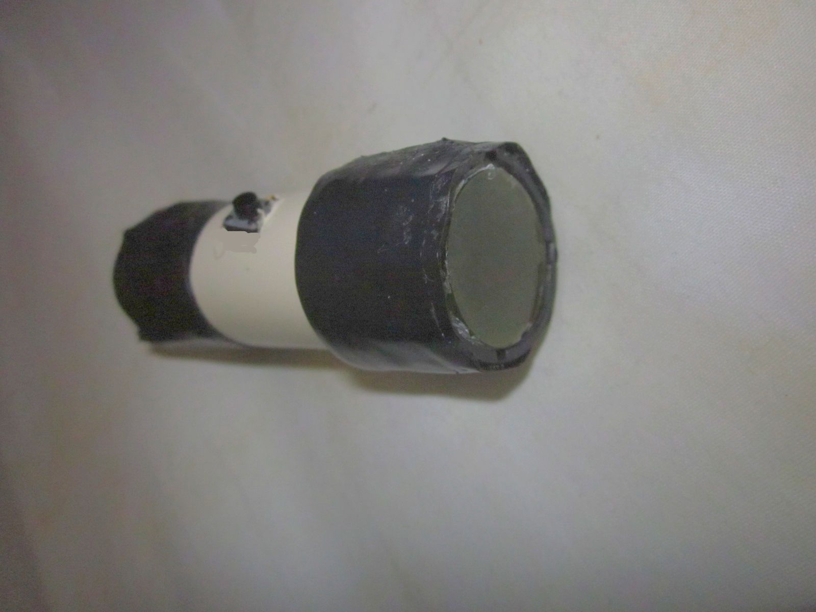

Step 3: Seal It, or Box It
I did not box this one, as I wasn't planning on using it with high voltages.
I merely sealed it in hot glue as pictured. It isn't very pretty, but it functions well.
Some tips as pictured, if you will be using insulated clips as I have, first thread the wire through the removed insulator as shown, and then solder / crimp it to the alligator clip.
If you plan on covering a large area with hot glue, it might be to your advantage to tape or cover in some ways, the device in case you need to use it outside in the heat, or inside repeatedly where it may get warmed by you hands or other source.
