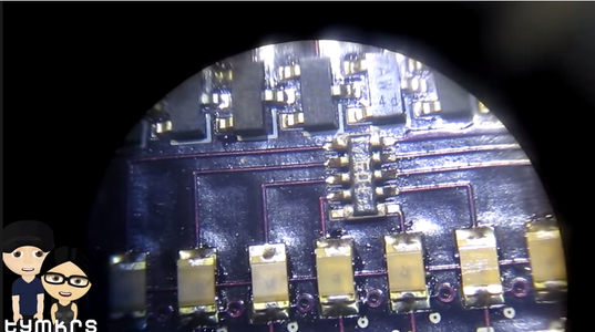

We were fortunate to get this SMD soldering station from http://thediyoutlet.com and I almost think we wish we had gotten this station from the start instead of having three separate tools that were more expensive and take up more space! We ran it through its paces by working on some SMD (surface mount device) soldering and rework as necessary.
So here I'll go through what all this station has and how we tested it! I'll also try to incorporate some tips on solder SMD sized items. I am most comfortable with 0805 sized SMD components and think it's a good starting place for those already comfortable with normal throughhole soldering.

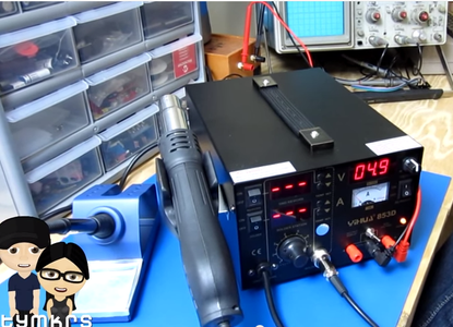

So this station has 3 items:
1) Soldering Iron - This comes with a stunning number (11!) of soldering tips of all different shapes and sizes - usually quite expensive for any other soldering iron.
2) Hot Air Gun - This is useful for when you don't want to have to use a toaster oven to take a single component off, it can focus an area of hot air to melt the solder on the component you're trying to fix. They also provide 4 different heads so you can focus the hot air on an even tighter area. Very useful if you're dealing with QFP/QFN chips.
3) Power Supply/Voltmeter - This useful power supply can output from 0 to 15V, 1-3A (I believe). And can read from 0 to 49.9V. Really quite a nice range.
This cost 120 bucks, which is SUPER reasonable since when we got the individual parts before discovering this, it totalled up to nearly 250 bucks.

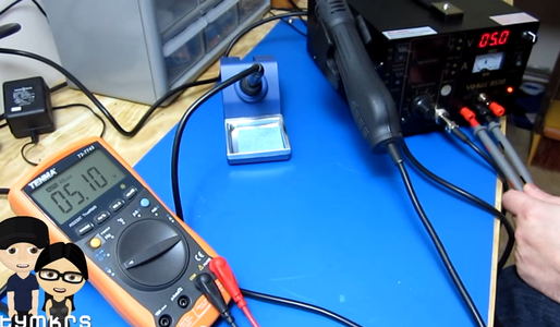

Step 1: Test the Power Supply Output

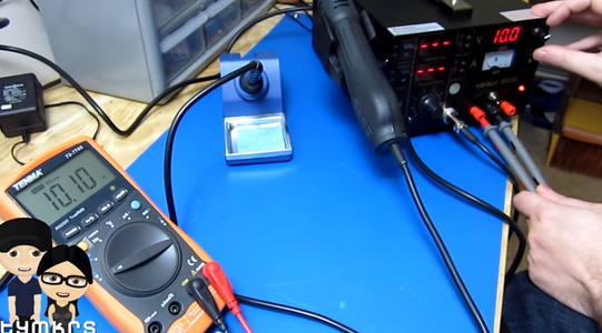

So the first thing we did was test the power supply. On the front there is a switch allowing you to choose either "Output Supply" or "Test Voltage". We flipped it to Output Supply, placed the red probe of our multimeter in the left lug, and the black probe in the black lug of the station.
We looked at what the display said it was giving us versus what the multimeter was reading. On the whole it was spot-on. In general, however, there was a 0.01V difference between what the station said it was outputting and what the multimeter was telling us.

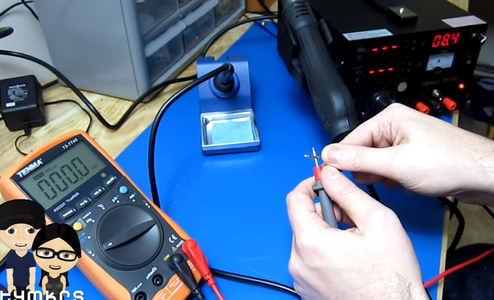

To make sure this isn't the multimeter introducing some sort of resistance, touch the two probes of the multimeter together to see if you need to adjust its voltage reading. Our's showed that there wasn't any confounding factor influencing the reading of the voltage. So we just knew that the voltage may be 0.01V off of the stated output.

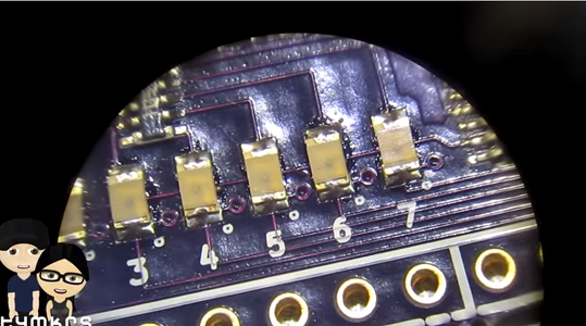

First step is to measure what your power supply is giving you with a known reliable meter. We connected the probes from the voltmeter to the cigar box power supply (red to red, black to black). Note the wires going to the cigar box in picture 4 :). In this example, our power supply put out 4.98V.

Brilliant design. And voila! Beautifully air gun reflowed boards. It worked faster than our normal reflow toaster oven as well!
