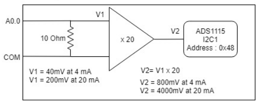

  • Each ADC module is capable of measuring a maximum voltage of 4.0V. So considering this into account and to achieve a measurement of 4-20mA the above arrangement is made inside the device using an amplifier and resistor.
  • Hence it is to be noted that the value read by the analog channels of the ADC is 20 times smaller than the actual analog input reading at the analog input pins A0-A5.
  • Here for measurement of 40mV (V1) at the analog input, the current value of 4mA gets mapped(40mV/10Ω). This value gets 20 times multiplied by an amplifier and read as 800mV at the analog channel of the ADC modules. Hence the measurement of 4mA is ensured.
  • Similarly, the measurement of 20mA is achieved.

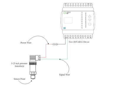

Step 7: Circuit Connection and Verification
  • Make the above circuit connection and upload the code to measure the current (control signal) sensed by the pressure transducer for your required application. (Water management, Pneumatic, etc).
  • The current value sensed by the transducer will get displayed on the device screen.
