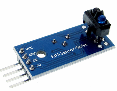

This experiment utilizes the HJ-IR1 infrared line-following module. The module's infrared-emitting diode continuously emits infrared light. When this light is reflected off an object, it is captured by the infrared receiver, which then outputs a signal for processing by the Raspberry Pi. When connecting the Raspberry Pi to an external display device (such as a debugging monitor), the choice between DVI vs HDMI interfaces often arises: HDMI supports simultaneous transmission of audio and video signals, enabling higher resolutions (e.g., 4K) and refresh rates. This makes it more suitable for debugging scenarios requiring real-time viewing of vehicle operation data and visuals. DVI interfaces transmit video signals only. If basic display is sufficient and the device supports only DVI, it can serve as an alternative solution, though additional audio equipment must be connected.

Step 2: HJ-IR1 Infrared Tracking Module

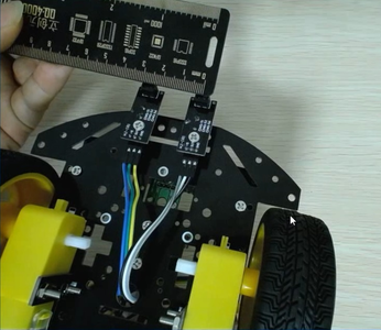

Step 5: Installing the Line-following Module
During actual testing, it was observed that the car tends to drift off the curved black line while following it. This may be due to either excessive speed or an overly long detection interval. Excessive speed can be mitigated by reducing the car's speed. A long detection interval might result from the detection loop running too infrequently. By the time the deviation from the black line is detected, the car may have already drifted off the line.
This may occur because the loop detecting the line-following module's signal includes checks for other sensors, or because the loop only runs at specific intervals to detect other sensors. Therefore, I employed multithreading programming techniques. I created the function for detecting the line-following module's signal as a separate thread. This ensures it does not interfere with other sensors or loops, or runs in parallel, making the line-following control highly responsive.
Step 6: Experimental Procedure
Step 1: Connect the circuit.
When connecting the circuit, link the Raspberry Pi's GPIO.23 (corresponding to BOARD number 33) to the output terminal of the left tracking module, and GPIO.24 (corresponding to BOARD number 35) to the output terminal of the right tracking module. Simultaneously, the Raspberry Pi's 5V port supplies power to the VCC terminals of both line-following modules, while the Raspberry Pi's GND terminal connects to the GND terminals of both line-following modules.
Mounting distance for the bottom of the car with added line-following modules.
