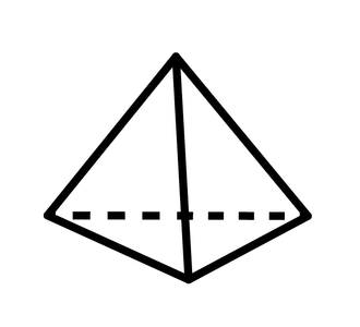

Step 1: Fold the Tetrahedron
Cut the plastics into the shape as the picture. The width of the triangle is 3.5 inch. You can adjust the size, but make sure it's not too small to fit all the circuit in.The plastics may be a little bit hard to work with. Make sure you use a folding bone to score it before you start folding.

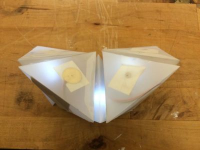

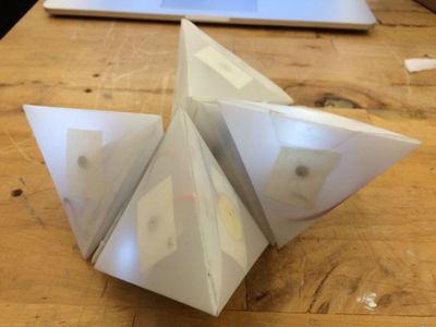

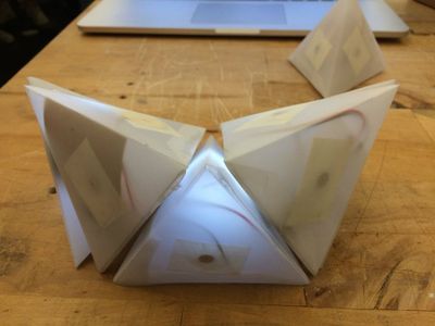

Step 3: Assemble the Tetrahedron
Put the circuit inside the tetrahedron. Make sure the circuit is working before you put it in.
Tape the piezo and the magnetics together on one of the side of the tetrahedron. And put three other magnetics on the other three sides as well. Watch the positive and negative side of the magnetic and make sure they attract when two tetrahedrons are put together.
Step 4: Finish and Play!
Make as many pieces as you want! Now you can start to play with your module lights and assemble them in different ways as creatively as possible.
