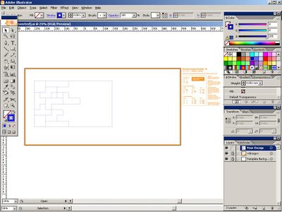

Step 2: Preparing the Artwork

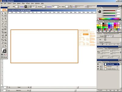

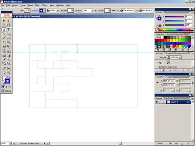

I used illustrator to create the artwork for my mirror. RazorLAB have a handy starter kit which explains how to prepare your drawings ready for laser cutting. I designed the mirror so all the shapes slotted into each other (as with Tetris) making it quicker to cut (and also cheaper!), rather than cutting the shapes individually. They can then be spread out to imitate the game in action when it comes to fixing them to the wall. I took inspiration for the shapes from images of Tetris I found on the web, and it would be possible to use any number of combinations!
Step 3: Transfer the Drawing to a Template

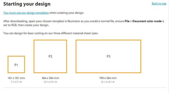

To use RazorLAB for the laser cutting, the drawing needs to be transferred to one of the design templates, specifically the p3 size (384 x 790mm). It's then time for last minute double checks on line thickness etc to make sure the drawing is ready to upload.

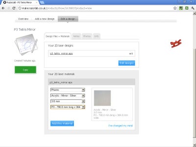

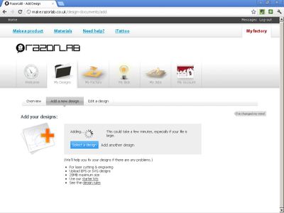

Once the drawing is finished, save it as an EPS file as instructed in the starter kit and upload it to the RazorLAB website, where material can then be chosen.The material I use for the Tetris Mirror is 3mm silver mirrored acrylic, but gold mirrored acrylic also works well (you could even make one in each colour and interchange the pieces). Once the order is placed it's picked up by the team at RazorLAB and processed.
