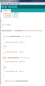

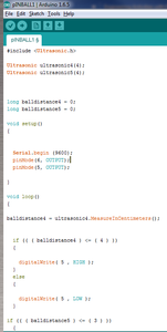

Step 11: Arduino Parts
Arduino parts:
· 1 Battery
· 1 Arduino kit
· 1 13 Hole beam
· 10 Thumbscrews
· 5 Straight block connectors
· 2 Wing nuts
