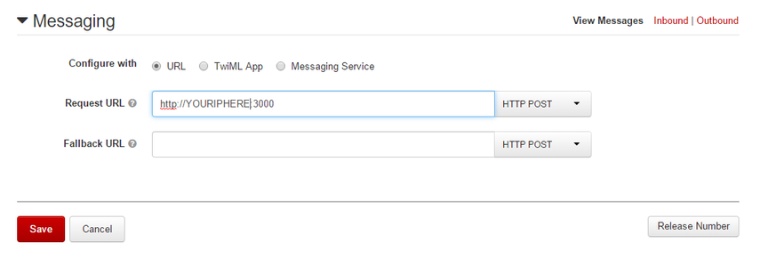

Step 3: Twilio Configuration
Buy a phone number in Twilio and get your API key and account SID. After you have done this, find your phone number in the Twilio dashboard. Click on your phone number in the menu. Scroll down to the "messaging" section of the screen and put your ip address into the box like so: ""http://yourIPaddress:3000". If you do not know your global IP address, you can get it from this website: http://www.ipchicken.com/
After this is done, your Twilio configuration should be finished.

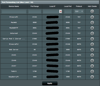

Step 4: Port Forward
The next step is to portforward port 3000 to the local IP address of your Raspberry Pi. Every router will be set up a little bit differently. There are many tutorials on how to do this. Google your router and find out how to portforward. I attached a screenshot of what my router interface looks like.

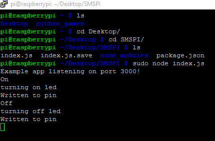

Step 7: Test
Start your webserver with "sudo node index.js". You MUST use sudo to start the program or else it will not be able to turn the GPIO pins on and off. Sudo gives the program root access (think of it like an admin account or super user privileges). Text your Twilio phone number with the word "on", and the LED should turn on. Text it with the word "off" and the LED should turn off.
The program will log things into the console for debugging purposes. If you experience an error, check the console.
