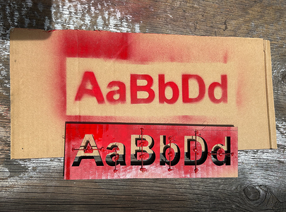

Stencils are a great way to make multiple copies of text, like a slogan or business name. But when it comes to some letters, there is a problem. Since the image is being cut out of the base material, only the outlines of the letter remain. For letters like "Oo" "Bb" and "Pp" the center white space falls out, which makes it harder to read (see attached example).

This techniques works best with large, bold letters but if you patient and dexterous, you can use finer fonts or smaller letters. The trick is to convert the text to outlines and then make a guide to show where to place a thin piece of wire to hold the center piece in place.
In my example, I created the text and converted it to black outlines. Any black line will be cut by the laser. Then I drew a red line over the letter, making sure it crossed over the center white parts of the letters. I will set the laser to score (mark but not cut through) the red lines. Then I can use the scored lines (red) as a guide to place and glue the wire to hold the stencil together.

Once you have cut your stencil out, make sure to save all the pieces. Place all the parts of letters with center parts back into the stencil. Like a puzzle. Using the guides you made in the design phase, cut pieces of the wire and place them on the guides. Then glues the ends of the wire to the background of the stencil and to the center pieces of the letters. Don't glue the wire to the outer parts of the letter. You want the center to stay the outer part to come out.
Once the glue has set, you should be able to pick up the stencil and the outer parts of the letters will fall out and the glue and wire will keep the center parts in place.
Step 3: Use the Stencil
Now its time to use the stencil. Lay the stencil on top of what ever you are copying the stencil to. Using spray paint, paint the stencil. If you spray form a few different angles the paint should go around the wire and fill in the whole area of the letters. You may have to practice a bit to find the best angels and amount of paint to use.
