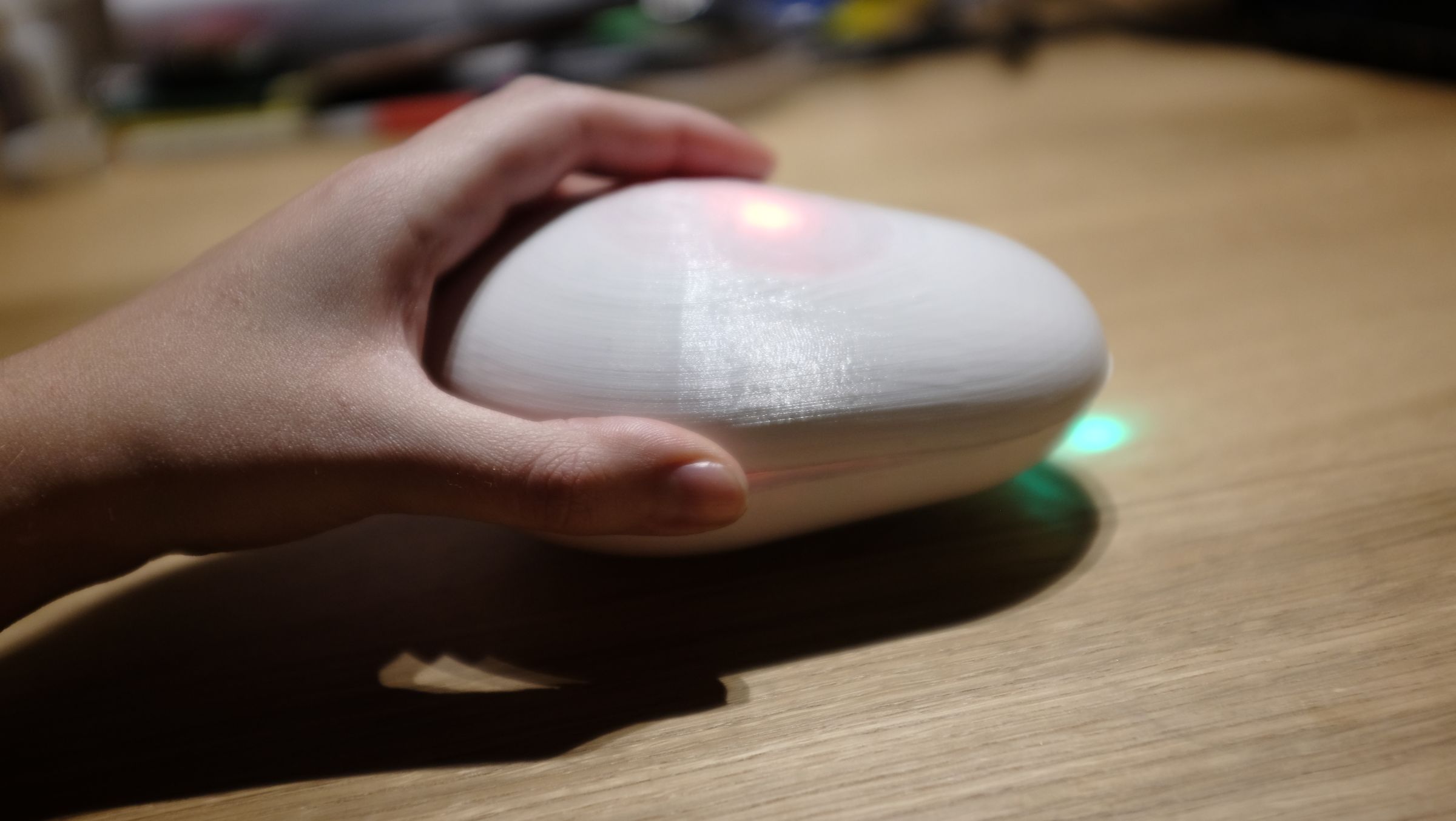

Step 3: Modelling & 3D Print
For the comfort of measurement and safety of electronics its advisable to make an enclosure. Moreover it prevents the components being short-circuited during the use. We designed a hold-able simple shape which follows the organic aesthetics. It is divided into two parts: bottom with hole for the pulse sensor and holding ribs for Arduino and breadboard, and a top one with a light guide to give a nice visual feedback.
Step 4: Electro-mechanical Prototype
Once you have the enclosures ready, place the pulse sensor into the guiding ribs in-front of the hole. Make sure the finger reaches the sensor and covers up the surface completely. To enhance the effect of the visual feedback, cover the internal surface of top enclosure with an opaque film (we used aluminium foil) leaving out an opening in the middle. It'll constrain the light into a specific opening. Disconnect the Arduino from laptop and connect a battery of more than 5V (we used 9V here) to make it portable. Now place all the electronics into the bottom enclosure and close with the top enclosure.

Step 6: User Testing
Now when you have a ready prototype you can measure your heart rate to receive light feedback. Despite receiving information about your health you can play with different emotions and check the response of the device. It could also be used as meditation tool.
