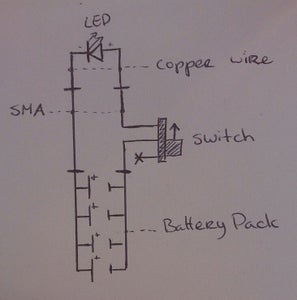

Step 3: Step 3: Batteries
The coin cell batteries originate from old broken bike lights (3V, 7.5mA), as did the LED light. To increase the current the 4 cells are connected in parallel circuit (the voltage stays 3V, current goes up to 30mA), this is enough to light the lamp and heat the SMA to the temperature needed for contraction.
How we did this is shown in the picture. We used electric wire to connect all plus- and minus-poles of the batteries. The wires are kept in place by the isolation tape.
Step 4: Step 4: Electronics
The picture shows the circuitry of the product. The contacts were soldered to keep all in place.
