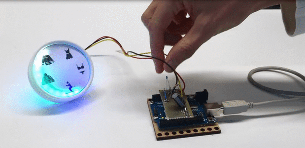

This arduino thermometer gives color feedback on ambient temperature, together with an indication of how much clothing you should be wearing.This thermometer measures ambient temperature with a thermistor and gives feedback with a neopixel. The scale along the neopixel indicates how much clothing you should wear in that temperature; perfect to hang outside your window!

2. Solder it
Use the following electronic scheme to connect all the components. Try it in a breadboard first to check that everything is working properly before soldering.

Step 4: Step 4. Make the Final Assembling
Place all the components into the casing after the circuit has been made and the code has been uploaded. A paper cover with a clothing scale or just numbers can be put over the LED lights to diffuse the light and to indicate the temperature.
Yay, now you can use your awesome clothing thermometer!
