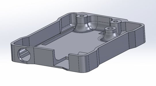

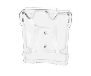

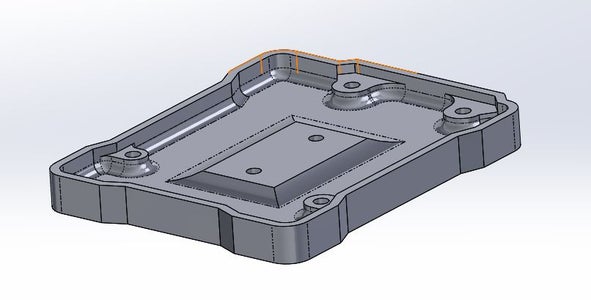

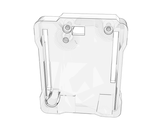

ArduinoUno_Case_bottom
ArduinoUno_Case_top

Step 4: Prepare the Arduinocase
1. Upload the attached code on to your Arduino.
2. Put the arduino in the 3D printed case and close it.
3. Connect the wires as seen in the image of the previous step.
4. Stick a strip of Velcro to the bottom of the case.
