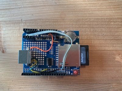

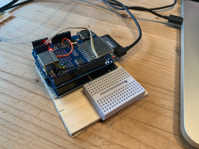

Step 1: Fix the SPI on the Shield

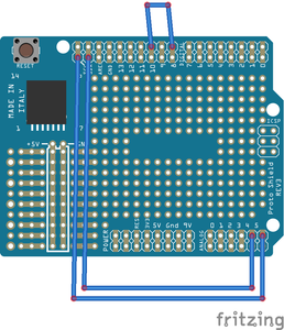

The shield uses pins 10, 11, 12, and 13 for SPI which is Arduino UNO standard. Pin 10 is the slave select pin SS. To avoid SPI slaves from activating during boot, the shield pulls pin 10 on HIGH with a small resistor. This is not uncommon and good practice when using SPI peripherals.
The designers of the Wemos board have attached one digital output of the ESP12 to this pin. They named it D10 and even labeled it SS on the board.
Unfortunately they have used GPIO15 pin of the ESP12 for this.
Now, ESP8266 board don't boot if this pin is pulled to high during boot. This means that practically no shield using SPI and (correctly) pulling up SS to HIGH will run on the Wemos D1 board. The board designers could have used any other ESP12 GIO for it but that would have made their life just a little more complicated because it would have made the board layout more complex.
A simple solution for this is simply to bend the D10 pin upward or remove it altogether like it is shown in the first image.
With this modification the microcontroller will boot correctly.
To use the SD card on the shield, another pin of the Arduino has to be connected to the pin of the board. The best choice is to use D8. It is close to pin 10 and it has no special function on the ESP8266. It is a no interrupt pin and can only be used as digital I/O.
To make the shield work solder a little link from pin 8 to pin 10 on the board. Now, the SD card can be used.

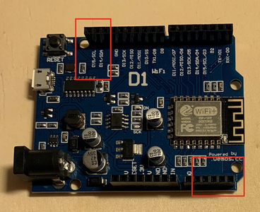

Step 2: Fix the I2C Wiring
The Wemos board uses the pins in the upper left corner next to the reset button for the two I2C signals SDA and SCL. These pins are connected with GPIO 4 for SDA and GPIO 5 for SCL. These are the standard ESP8266 I2C GPIOs. These two pins are also connected to D3 and D4.
An Arduino UNO also would also have the SDA and SCL pins on the upper left. They also use the A4 and A5 pins diagonally on the other side of the board. The two sets of pins are connected.
The Wemos D1 board designers did not do that. The pins A2-A5 on the bottom right corner of the board are unconnected. They could have connected A4 and A5 to the standard ESP8266 I2C pins as well, but they left this away.
Unfortunately, the shield expects SDA and SCL on pins A4 and A4. There are no extra SDA and SCL pins.
This can be fixed on the shield adding two wires to connect the right pins a shown in the schematics.
With these two modifications can use the shield on the Wemos. There is a real time clock, an SD card and a working I2C bus for all kind of sensors.

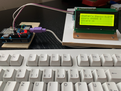

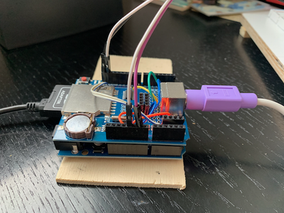

Step 3: Add the Keyboard Socket
To build a standalone computer a keyboard is needed. PS2 keyboards can be connected easily. The PS2 socket can also be used to connect other peripherals.
PS2 needs two pins, one of them for the clock signal and the other for data input. The clock pin has to be interrupt ready. The only free interrupt ready pin of the Wemos with the shield is pin 9. Pin 8 cannot be used for interrupts on the ESP8266. This is the reason why pin 8 is used for the slave select and pin 9 is left free in the shield modding. Pin 2 is available for the data connection of the PS2 socket. Connect the pins to the PS2 connector like it is shown in the drawing.
The complete shield now has quite a few wires on the top and can be mounted on the Wemos D1 R1 board. I usually put them on a small piece of plywood and add a breadboard if I use the parts in the lab.

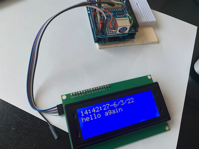

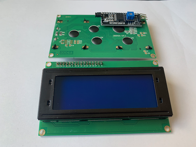

Step 5: Add a Display
For this extension you will need a 20x4 LCD display with an I2C interface. Smaller displays also work but the display dimension have to be changed in the BASIC code.
Power the system down, then connect the display to the 5V and GND power pins and to the SCL and SDA pins of the microcontroller. Restart the system.
PRINT &2, "hello world"
should show the text on the screen.
PUT &2, 12
clears the screen. 12 is the ASCII value for form feed. &2 is the display output stream. The display can scroll and has a subset of the VT52 control characters for cursor control.
If you don't see anything, check the brightness control at the back of the display.

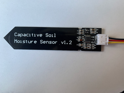

Step 7: Measuring Data and Sending Them Via MQTT
A typical device to connect to a board like this could be a soil humidity sensor. Every Arduino hobbyist has one laying around somewhere. Alternatively, an analog light sensor could also be used.
Connect the sensor to the power and the analog input A0 of the shield.
In BASIC, analog data is read with the AREAD() function. Check the sensor by typing
PRINT AREAD(AZERO)
The output should be a value between 0 and 1023 according to the conventions of Arduino analog data.
A small BASIC program to measure the soil humidity periodically and transfer the data to the MQTT broker could look like this:

Step 10: Receive and Display MQTT Messages
Type in NEW to clear the program storage, then enter a small MQTT reader program.
10 OPEN &9,"iotbasic/commands",0
20 IF AVAIL(9)=0:DELAY 1000:GOTO 20
30 INPUT &9,A$
40 PUT &2,12
50 PRINT &2,@T$
60 PRINT &2,A$
70 GOTO 20
Save the program by typing in
SAVE "display.bas"
and run it with RUN.
When the program is running, send MQTT message to the topic iotbasic/commands using EasyMQTT and see them displayed on the LCD screen with the respective time stamp.
Line 20 in the BASIC program checks for incoming messages every second and loops until a message is reached. Please note that MQTT messages are received asynchronously by the system. The real MQTT client loop is hidden in the BASIC interpreter. It runs at a 32 ms pace.
Step 11: Connect a Keyboard
We are now ready to connect a keyboard and make the computer standalone.
PS2 is not hot pluggable. Please disconnect the microcontroller from your computer, plug in the keyboard and then reconnect it. Some PS2 keyboard don't initialize properly at power up. They need a lot of power and charging their internal capacitors takes a bit too long. Disconnect the system briefly from power and reconnect it, if this happens. Observe the keyboard status lines.
Keyboard IO is done through the input channel &2 in BASIC. Code like
INPUT &2, A$
lets you input data from the keyboard.
If this works you can recompile the interpreter with the flag
#define STANDALONE
which makes it a standalone system with keyboard and display I/O as the default. Read more about this im my wiki https://github.com/slviajero/tinybasic/wiki or in the chapter https://github.com/slviajero/tinybasic/wiki/Projects:-3.-Rockwell-AIM-65-lookalike-computer
