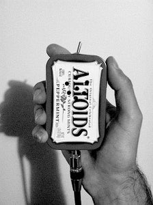

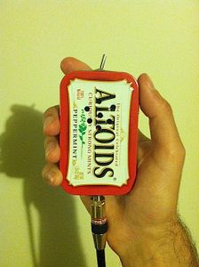

In need of a quick way to get yourself heard? Try the 10 Minute Altoids GhettoPhone! For under ten bucks and in no time flat, this trendy little microphone will have you screaming and screeching with the sound of the blues. It sounds like the old harmonica microphones of yore and looks even tastier! You can make it with parts laying around the garage.

At this point I must admit my lack of expertise when it comes to drawing any sort of schematics... so I drew you a picture! You only need to solder 4 little contacts and you're ready to go. NOTE: The switch is wired from the middle prog and the left prong if you are facing the switch with the 'ON' direction to the right (as in the picture).

Step 1) Use the nuts that came with the audio jack and the toggle to bolt them to parts to the holes you drilled on the right and left walls of the tin.
Step 2) Glue the condenser mic element (or piezo buzzer) to the inside back wall of the tin. Make sure you center it with the pattern you drilled out on the top surface of the tin.
Step 3) Close the box. You're ready to rock.

Congratulations! You've made the 5 Minute Altoids GhettoPhone! All you have to do now is plug a quarter inch cord into the audio jack and connect that bad boy to a PA system or guitar amplifier. WARNING: Don't stand too close or directly in front of whatever speaker system you're using. These things feedback like crazy! If you're having problems with feedback, I noticed that packing the open spaces in the tin with cotton swabs seems to help a good amount.
