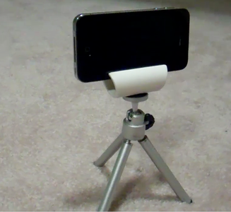

This ible will show you how to make a iPhone or Smart phone tripod mount in 10 min using basic tools in your shop. With this you can attach the phone to a tripod. Also i find attaching it to a mini tripod gives you a handle that you can do way better hand held shots that are exponentially more stable and watchable.

Step 2: Miter Box Time
First 2 cuts
- Using the miter box cut one end of the PVC at 30 degrees
- Next estimate 3-4 inches (This high accuracy measurement has a very technical term' SWAG' to it (Scientific Wild Ass Guess)) and cut the other end of the PVC with an apposing 30 degree cut
Step 3: Drill the Tripod Mount Hole
The tripod mounting hole magic...
- On the short side SWAG the center of the tube at the short end of the longitudinal 30 degree cut... Confused by the big technical terms? Then check out the pictures
- Drill a 13/64 Hole
- Then tap it 1/4-20
Clamp the PVC down when doing this but the PVC is soft enough you should be able to hand hold it like I have.
Step 4: Second Two Cuts
Second 2 cuts
- Using the carpenters square rest the PVC in the crotch between the black plastic and the metal ruler this will allow a square line to be drawn along the length of the PVC and mark the longest edge
- Measure the width of the phone and subtract a 1/16" from that number
- mark two more lines on either side of the first line drawn using the first line as the center
- Put the PVC in a vice and snug it up but dont crank down on it. We want it just tight enough to hold the PVC while cutting it and no more
- Cut along the two outside lines
Step 5: Attach to the Tripod and Deburrrrrr
Attach the PVC now to the tripod and using the tripod as a handle deburrrrr rrrr rrr rr all the edges
Then after the deburrrrrr ing do a final clean up with the course file
Step 6: Mount the Camera and Use That Bad Boy for Steady Shots
Place your phone in the holder and take some shots. This is a tight fit FYI and if you have any plastidip <- (click the link if you don't know what plastidip is)coat the clamp areas that touch your phone with it (and let it dry for 4 hours) this will give it a rubbery grip.
