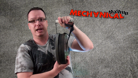

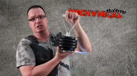

For Kettlebell #1
This is for the home steel weights you may have lying around...
- Take the 5" PVC handle and run the rope through it
- Tie the first half of the double fisherman in the rope
- Push the loop through the second PVC pipe
- Get the length of the rope needed by having the loop just peak out of the end
- Tie the other half of the double fisherman and cut off the extra rope
- Place the weights on the 6" piece of PVC with the hole you drilled at the bottom
- run the rope loop through the PVC
- Place the linchpin through the hole in the PVC and capture the loop of rope
- Tighten the rope with a tug to the handle
- DONE!
Step 6: Kettlebell #2
Kettlebell #2
This one is for use with the gym weights that have bigger holes in them
- Take the 1" tubular webbing and tie a overhand knot in one end (note this is only 1/2 of the weave back knot)
- Put the tail of the rope through the center of the weights you want to use and through the handle
- Take the tail end and weave it back through the overhand knot you made in step one with as little webbing (shortest length) as possible
- Cut extra webbing off
- DONE!
