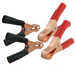

  • (optional) Insulated Car Battery Clips Alligator Clamps
There are many varieties of solar panels, make sure the model you purchase comes with the charge controller. The variety I selected comes with small alligator clips to connect to the battery. If your battery has flat terminals it'll work great, otherwise you may need to buy additional clips.

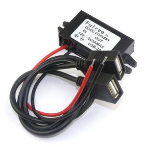

My goal was to run a computer off 5v USB power, so I chose a 12v->5v/1A transformer. If you need more or less power, select a different transformer. If you want to power 12v stuff YOU DON"T NEED THE TRANSFORMER.

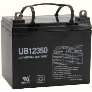

Any 12v battery will do, old, new, however IT MUST WORK and be able to HOLD A CHARGE. Get a new one for your car, and use the old one. I bought a new tractor battery because it had a smaller footprint and smaller terminals.
How many things do you want to power? If you have a bunch of stuff you want to power up you will need to use a terminal block to safely distribute power. I wanted 12v AND 5v power, so I used a terminal block to wire it up. I The model of transformer I chose specifically because comes with 2 USB connections for easy 5v computer connections.
